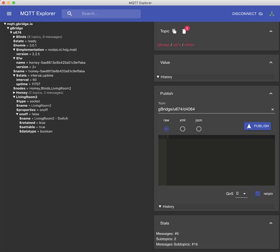

Here we go MQTT Explorer’s screenshot:
And my device at gbridge:
Whats wrong here any help please?
Thanks,
Set belongs on the other side and you are not allowed to use capitals. So:
action: …/livingroom2/onoff/set status: …/livingroom/onoff
Thanks, So I need to keep the whole lines like this?
Action : gBridge/u674/d4064/livingroom2/onoff/set
Status : gBridge/u674/d4064/livingroom2/onoff
Thanks,
You also need to delete the “d4064” part of the topic. It’s some default naming thing from gBridge that does not belong.
Check the first post (the guide) and look at what the topics contain there.
gBridge/Username (u674)/name of device/capability/(set, if action)

Also if you have the setting “Normalize” set to OFF in MQTT Hub you are allowed (and must) use capitals. If you set it to ON then spaces turns into dashes (-) and capitals turns lower case. But both should work as long as you type it in exactly as they look in MQTT Explorer (IMPORTANT!!). I prefer normalize on but it’s not a necessity.
