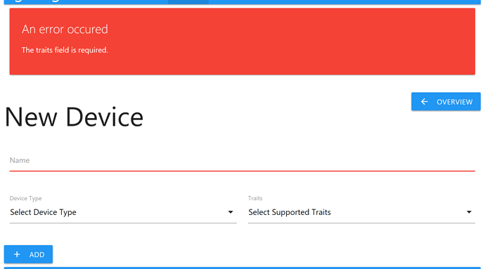

Also try to install and when i want to add device in gbridge website i have an error.
An error occured
  • The traits field is required.
That’s because you have to select a capability for your device (on/off, dim, …)
yes i dit fill in all de fields and still the error
And when i push add tis is the problem
