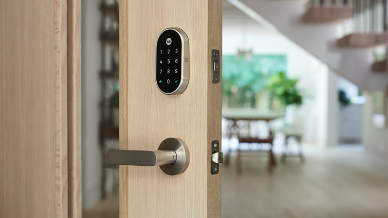

I tried a smart lock without success. I think the topic is not supported bij Google Home… Not sure though!
I don’t believe Google Assistant supports control of locks , this is intentional as it’s a real security risk someone shouting in your window ‘little pig, little pig …let me in’ .
Hope that translates OK
I don’t think that’s the problem…
Maybe… but a review of say the Nest x lock says it’s the best integrated and you can use Google Assistant to lock it but not to unlock… I have no electronic locks here so I’m not in a position to contribute really…
