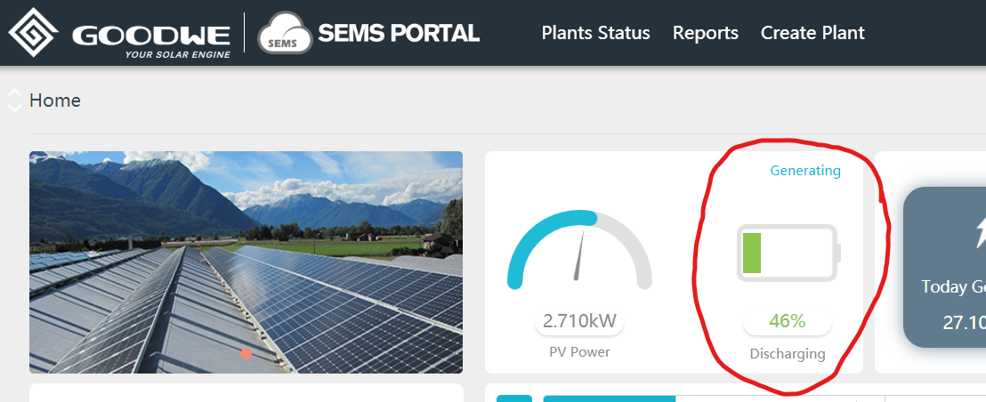

Yep, it is tied to the Goodwe system, and the state of charge (SOC) status is passed to the SEMS portal as shown below. The SOC should be available via the API as I previously used a python script (written by someone else) to pump the SEMS data into the PVOutput.org portal. I can dig up that python script if it would be helpful or interesting?
