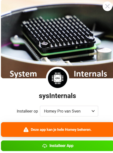

FWIW The SysInternals app somehow determines the model ID, dev Geurt Dijker might be able to tell you more about it.

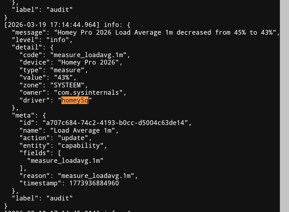

Pro 2023 (and up) driver
Pro 2016-2019 driver
Found by searching the Audit app log
That app has the homey:manager:api permission, so that’s how it determines it

That’s just weird, needing full access to just get the model ID.
