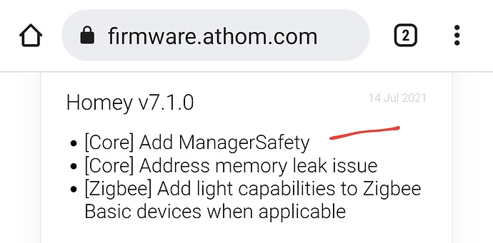

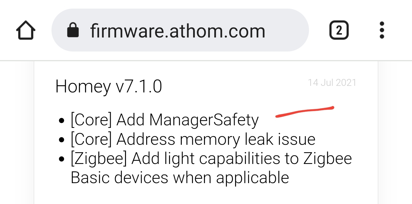

This was introduced with v7.1.0, and sends alerts without flows
In the timeline settings, you’d see an entry called “Safety” (or something like that), with the number of displayed messages)

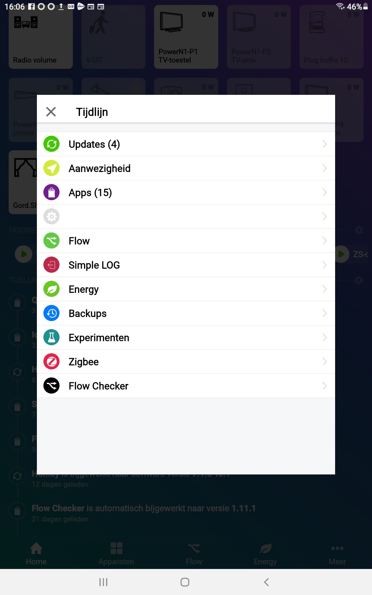

You have probably a nameless item with a gearwheel icon between Apps and Flow?
No nameless devices in my system…can’t understand what’s that alert :sweat_smile:
What I meant, was the 4th item in this page, it has the same icon as the items in your time-line, it should show the number of items in your time-line, and by pressing the arrow on the right, you can disable/enable the notifications for this item.

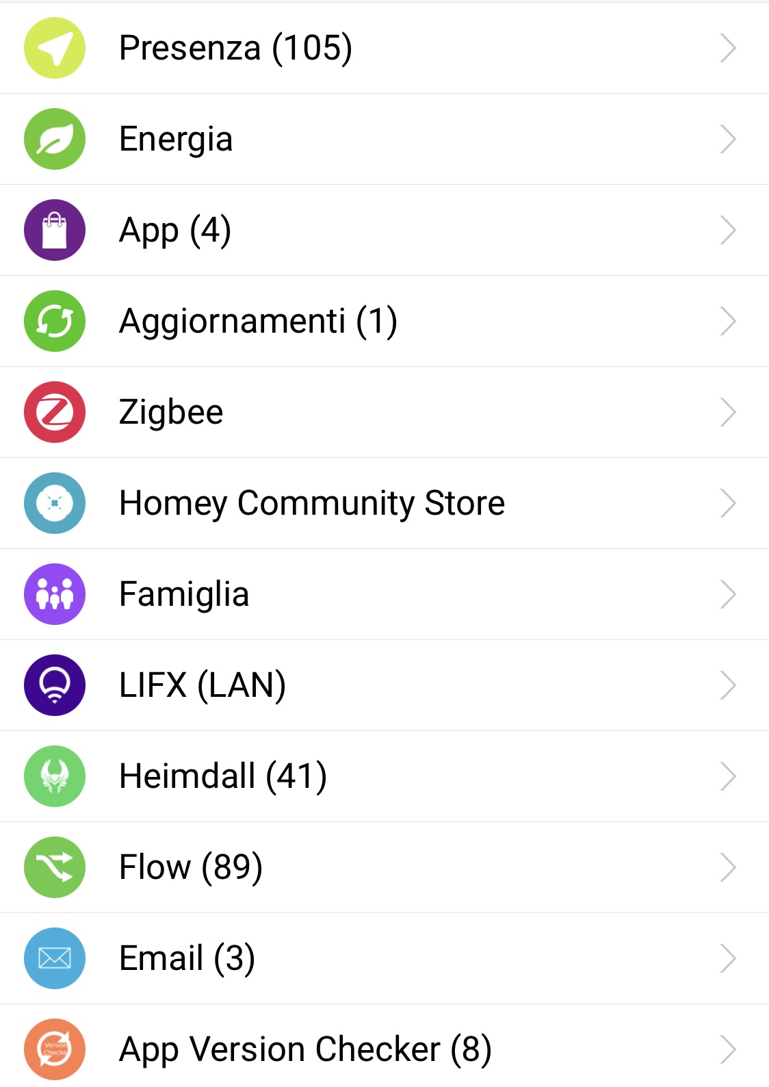

Oh sorry, got it.
No gear icon among the listed elements:
But the numbers here should give you an indication where the alerts come from…
