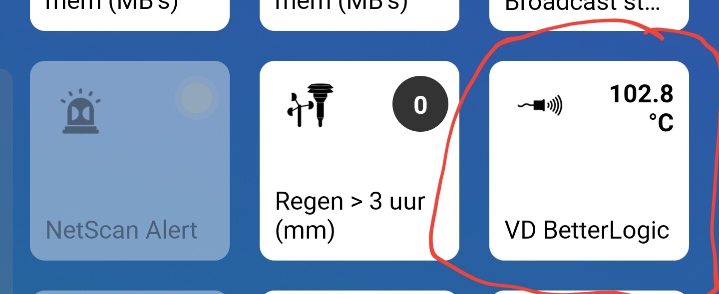

So, please, what is the smoothest way, to get a better logic variable in a virtual device?
Copy it into a normal logic variable, first?
Regards, Metatron
Just like Homey Logics NumVars, you can select a BL NumVar as value of a VD
