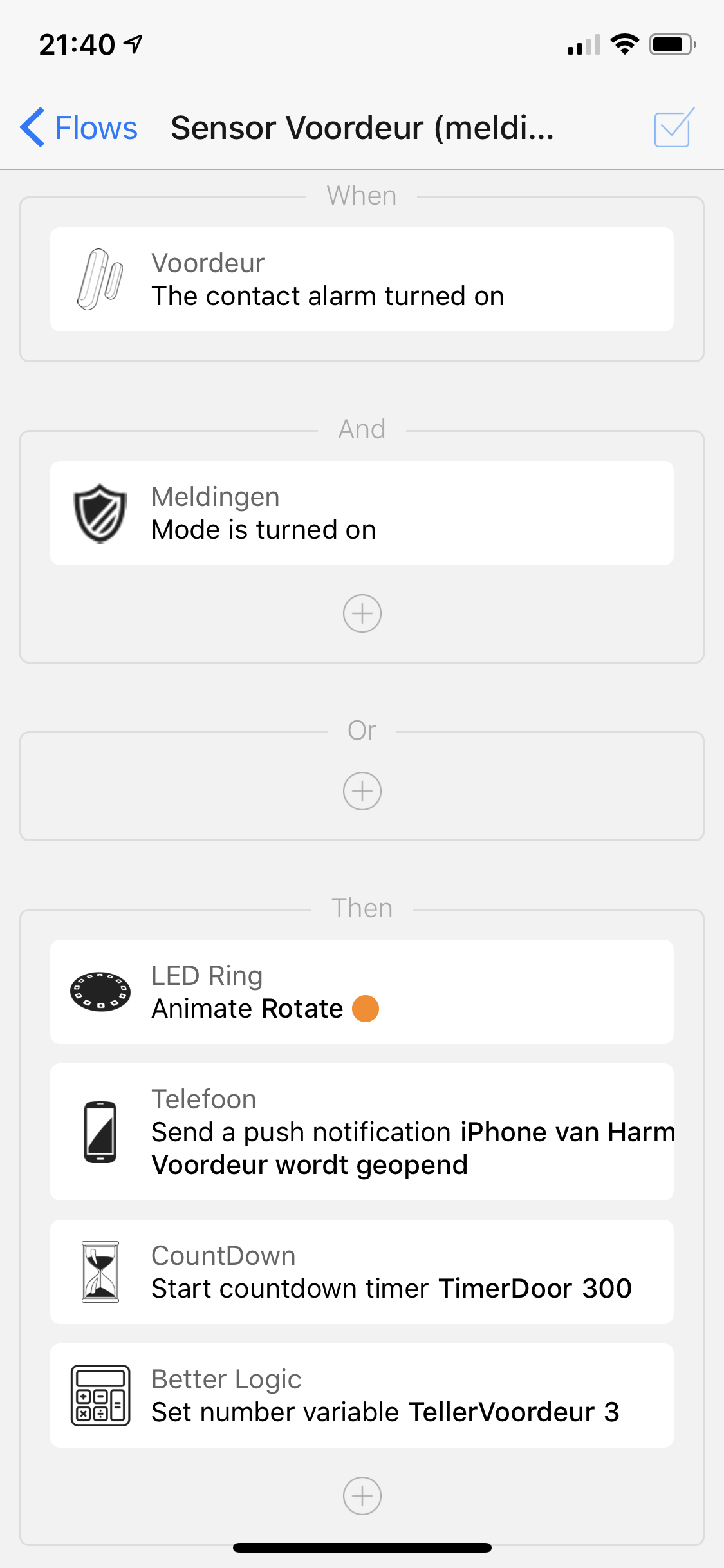

I have the same thing created for my front and back door
Make a countdown timer Gate
flow 1: IF contact alarm gate goes on THEN start gate timer at 3600 sec AND send Alert 1
flow 2: IF contact alarm gate goes off THEN stop gate timer
flow 3: IF gate timer value has changed AND value is exact 1800 sec(logica) THEN send alert 2
flow 4: IF gate timer value has changed AND value is exact 0 THEN send Alert 3 and whatever.

Meldingen is just a Virtual Device, so I can turn on/off the messages if I need.

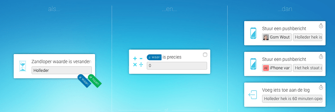

Installed the Countdown App and created 4 flows:
Gate is open:
Gate is closed:
30 minutes reminder:
60 minutes reminder:
