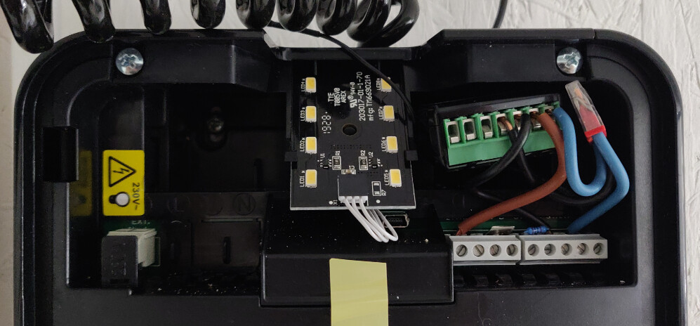

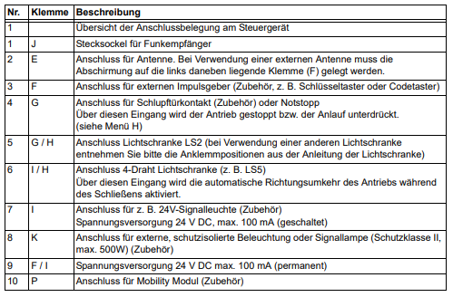

The Novoport has the following options to connect extras:

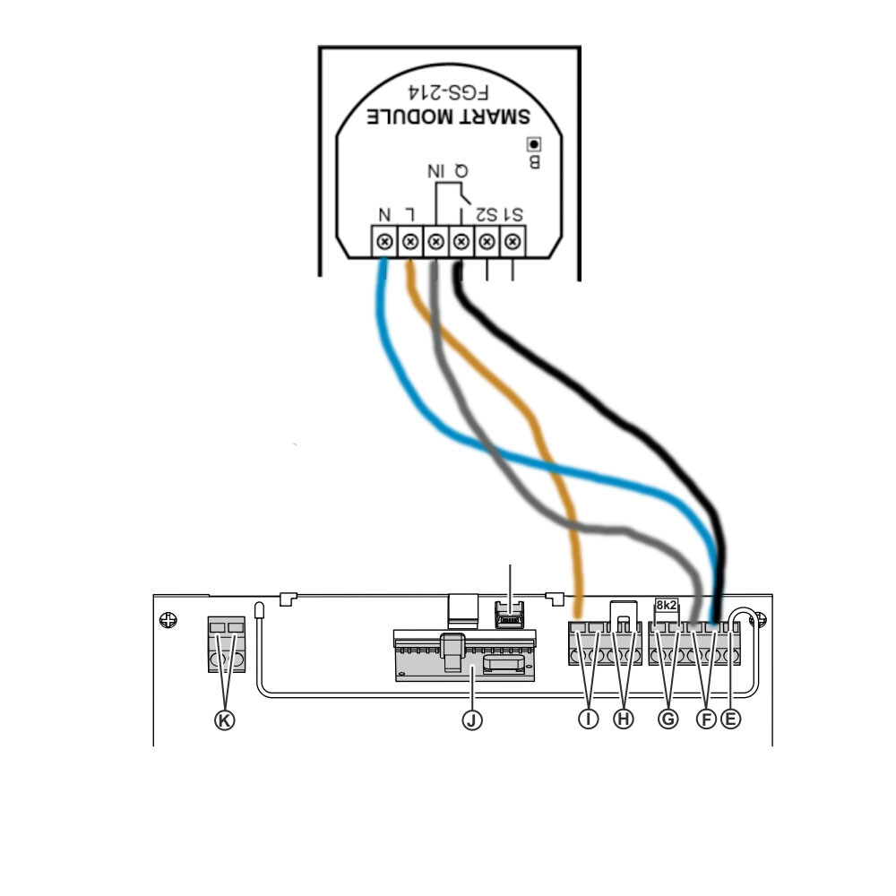

I used the Fibaro (Double) Smart Module:
Good to know is the Fibaro works on both 230V AC as well as 24V DC. Though you could tap 230V somewhere from the Novoport, it’s not in sight when the front lid is open. You cannot (!) use connector ‘K’ to tap 230V for the permanent feed of the Fibaro because ‘K’ switches off when the LED light from the Novoport is off.
What you can use is the permanent 20-24V DC between the left connector of ‘I’ and the right connector of ‘F’ (picture 9 in above picture) and connect these to the ‘N’ and ‘L’ of the Fibaro module.
To give a pulse / signal / power to actually switch, connect the left connector of ‘F’ and the right connector of ‘F’ to the ‘IN’ and ‘Q1’ of the Fibaro module.

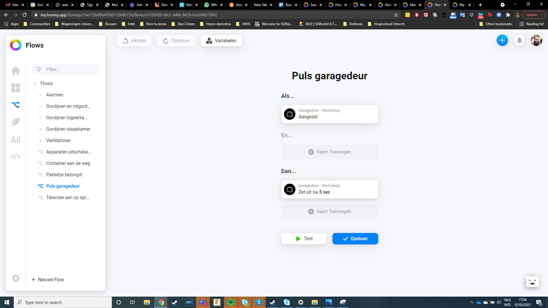

What happens when you turn on the switch of the Fibaro module is that you get a continuous 20V signal on the I - F bridge. This blocks any other signal to open or close, so your Novoport remote will not work. To solve this you need to cancel the signal after a short time with a flow in Homey:
It practically says ‘if garage door = turned on then turn off after 5 sec.’.

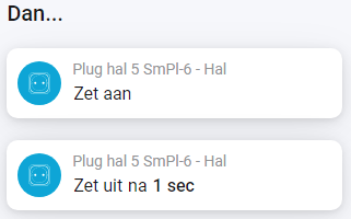

For the “pulse” via flow, you can combine the On and OFF into one flow:

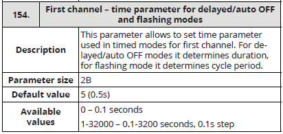

For the ''pulse" function it is also possible to use the setting for parameter 150, to auto off:
The timing for this action can be set in parameter 154:
Can you tell me where to change the parameters via homey? I can put the info in the raw parameters box like 150, 1B, 2 but I can not save it there.
I got it. No 1B and no spaces.
So 150,1,2
