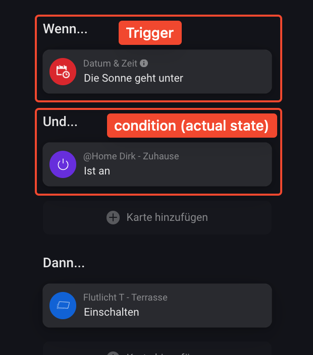

In the When… section only trigger cards are available. Trigger means status changes. Status changes are very short actions in time. E.g. something like “switched on”, the time changes from 10:00 to 10:01 (it’s less than a second), temperature changes from 14.2 to 14.3 °C, the sun sets (it’s handled like the time), a variable changes from Yes to No…
In the And… section only condition cards are available. Conditions are something like “is on” (not switched on!!!), it’s after sun set, it’s < 14.2 °C, the music plays…
So the only way is:
When…
– The sun sets
And…
– VD is ON
Then…
– whatever
I hope I was able to clarify the logic a bit.

You can use this in the AND section, for your purpose.

As I tried to explain, in the section And… (Und…) there are only condition cards (in your words: actual state) available.
Sorry, only in German language.
But it’s good that you understand it now.
