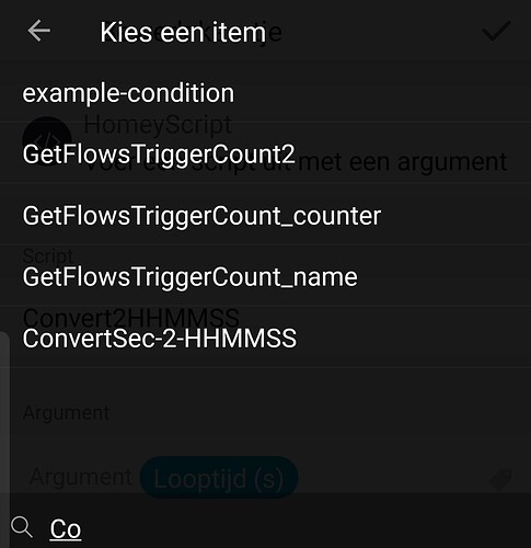

HomeyScript scripts can be renamed, but the ‘old’ name keeps popping up anywhere else, when you want to select the script, like in a flow.
I guess it’s not my Homey Pro only?

Now I don’t get why Athom introduced the possibility to rename scripts.
Screenshot from 2022-06-10 01-42-16
I know apps can’t update flows, but when I rename a flow or variable, the new name gets presented when I want to pick that flow or variable from a drop-down.
As you can see in the second screenshot, the changed Homeyscript name ConvertSec-2-HHMMSS isn’t presented in the drop-down.
~Peter
You are right this is indeed a bug com.athom.homeyscript/app.js at 9c528865ebcef7d00359b432c5834750230d7a44 · athombv/com.athom.homeyscript · GitHub this method still returns the id as the name. I will look into it :wink:
