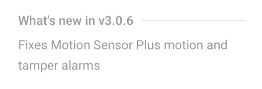

Yesterday Athom released a new test version of the app.
Before and after the installation yesterday of the 3.0.6 version I got a couple of tamper alerts (reported via Heimdall). This sensor never showed this behaviour before v5. I have removed the battery, triple pressed its button and set the sensitivity to 25 (was on 20). Have not received a tamper alert since (half a day). Possibly this has resolved my situation.
