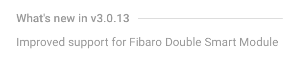

There is a new test version available:
Bildschirmfoto 2021-04-19 um 13.58.57
Btw. after updating the app, you have to reinclude the device.
