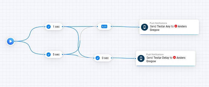

I started an Adv. flow which starts itself after 5s, but they really built in a limit appearantly:
Screenshot from 2022-07-07 00-09-13

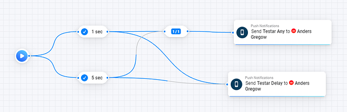

I tested Any card versus Delay(0sec) card and was expecting that the Any cards would stop all but the first signal, and that was correct.
But I expected the Delay(0sec) to let all signals go through but this did not happen. See my attached screen captured of the tests.
As you can see the behaviour is the same as for the Any card.
This must be a bug?!
Even without the delay only the 1 sec-signal is continuing.
Is this correct. Maybe I want the messages to be sent twice??
No by design within a Trigger all cards can start once,
So < ANY > = < Delay 0 Sec > = connecting all incoming directly to a < Condition or Action Card >
