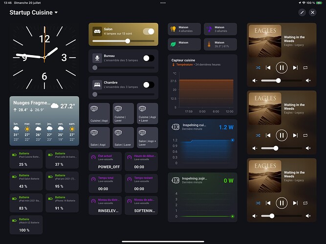

I have 4 Apple HomePods, a pair connected to my AppleTV, one in bedroom the last one in my office…
I also have a former girlfriend - the Home Assistant green (box)
I took some times this morning to play a little bit with HA (I had completely given up a year ago, when I discovered how simple Homey is)
I did a full update of everything on HA and install the Apple TV integration…
On Homey side I use the Home Assistant Community app to add my homePod as Media Player Item…
After that I can create media player dashboard to display live music playing
I can control my playlist (next/prev) and the volume
To my great surprise, the cover perfectly matches the music.
the transition between song match the live streaming
I also add the Apple iCloud integration to expose my devices, mainly to keep track of mobile device batteries.
So if you have HA and apple devices you want to manage with our favorite tool, there’s a way
