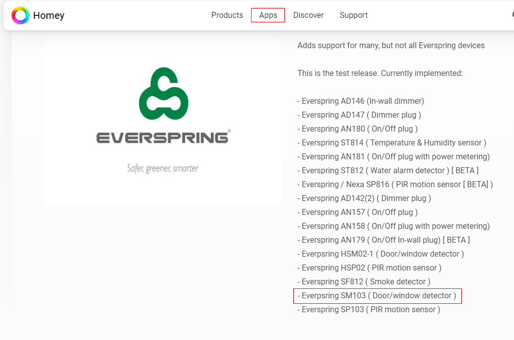

Thank you for your reply, the device is added already to the app:
I guess contacting the app developer is the way to go.
Ah sorry, didn’t checked the App Store.
