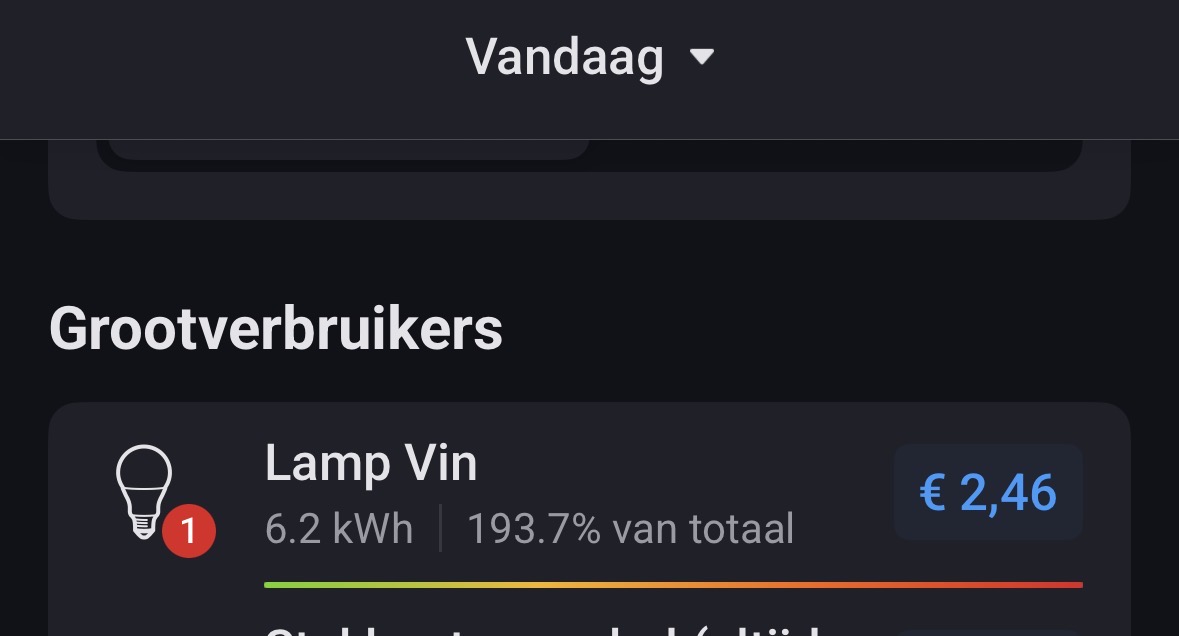

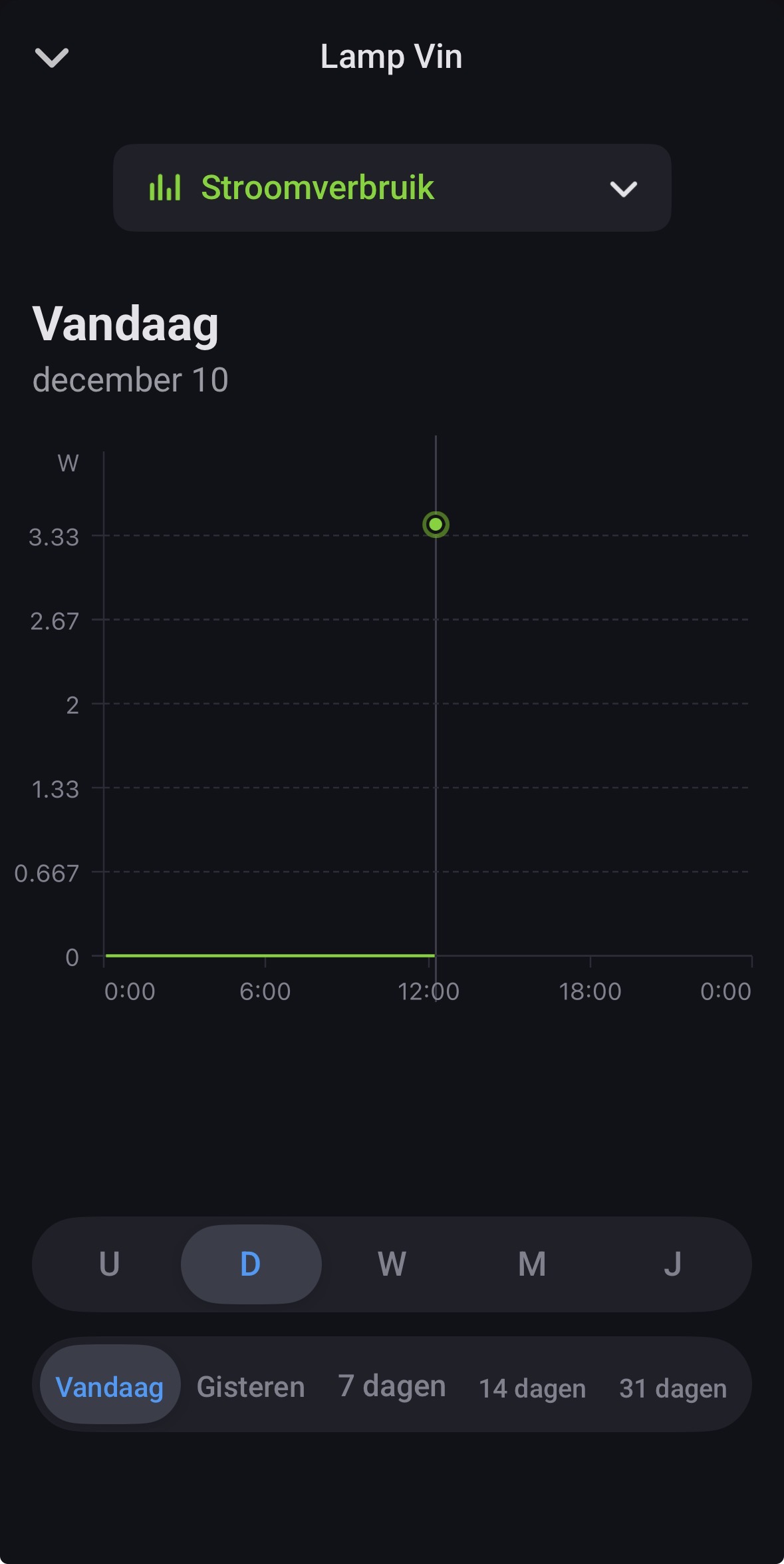

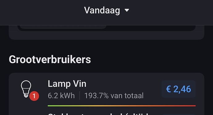

Here are some screenshots.
Thank you Rob,
I cannot explain, why in the first screenshot there are 6.2 kWh, but in the energy part it says 1.5x kWh. And the downpeaks are some temporary data errors.
But it is clear, why the energy chart is quite stable at around 1.5 kWh. You need many (30) hours with 3.3W power to increase the energy remarkably (by 0.1 kWh). So you will need about 2 hours a day light to get this small increase seen in one your. So probably the 1.5 kWh and the 6.2 kWh are wrong, but frankly speaking there is no use to measure the power consumption of a 3.3 Watt lamp.
