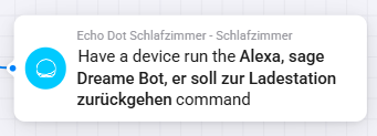

As long as there is no official app yet, there is a small workaround — but only if you have an Amazon Echo device. You can connect your Dreame to your Echo device using the Dreamehome Skill (Amazon.de: Dreamehome : Alexa Skills).
Then, you’ll also need the Amazon Echo Homey App (Amazon Echo App für Homey | Homey).
This way, you can at least use your Dreame in flows.
The following commands work in German:

In the Homey flow card, it then looks as follows:
