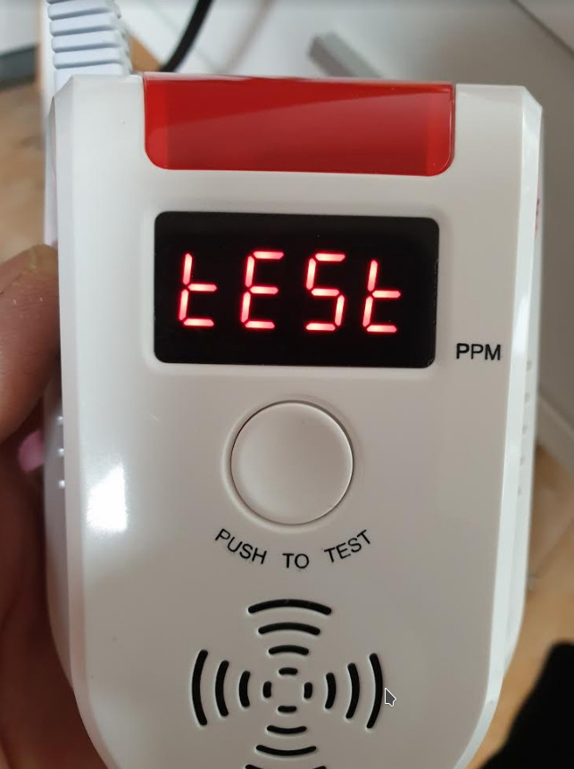

From Aliexpress i ordered this gas leak detector:
As i tested it detects quiqly natural gas and sound very loud with strobe lamp

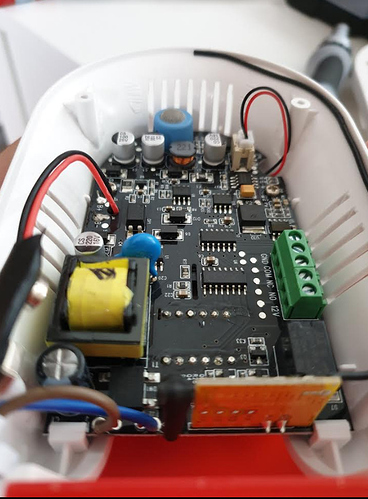

It has 433mhz transmitter already inside but as we know Homey cannot learn 433Mhz signals and its also bad idea to use 433mhz as its not reliable.

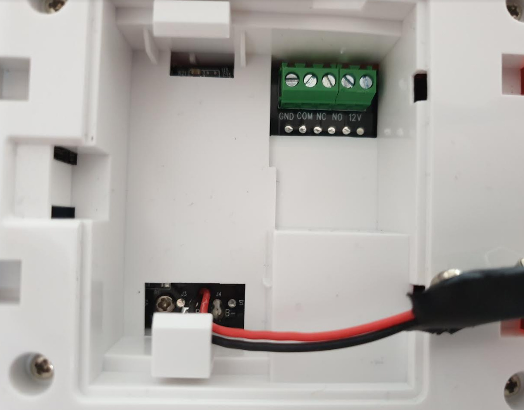

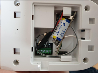

That why i used Neo coolcam door sensor ( also xiaomi door sensor is perfect)
Inside
Back
Final result

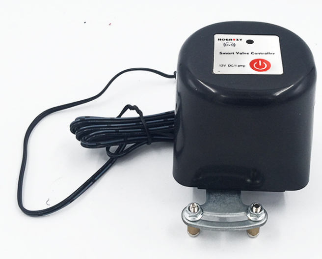

And combination with door sensor and flow that sends message and close gas valve
Nice job. Only drawback imho is that you don’t have room for the 9v battery anymore. So no backup in case of a power failure.
Yes i thought about it and will use xiaomi door sensor as small enough to fit along with battery inside.
But at the moment i’m waiting it to arrive from china
You could try to put the door sensor on the outside, it’s just 2 small wires. Then you can swap the battery easy if necessary and always test if it still works with a magnet… :stuck_out_tongue:

Which gas valve do you use and how did you connect it to Homey?
