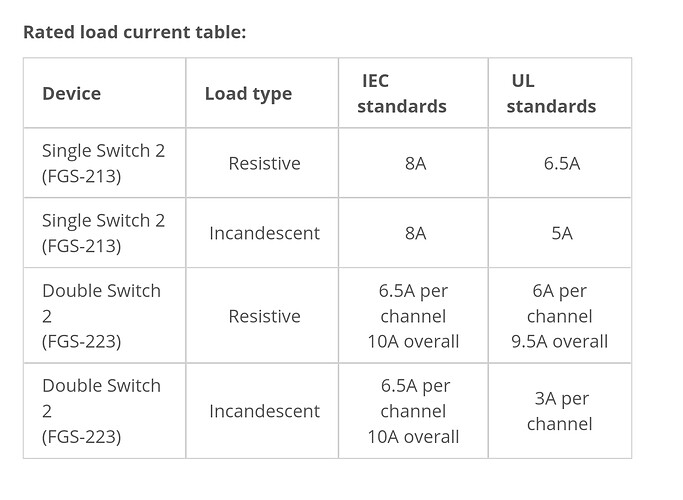

@mattrix:
Is the pic from your car charger? It uses 10A max.
What are the specs of the fibaro plug? I recommend at least a 16A capable plug, NOT a 10A version.
Looks like @Jo_San has the correct answer.
A lot of webshops advertise the single switch 2 as capable of handling 2500W but it seems that it isn’t (or at least not for all load types and only for a short time).
Thanks so much for sharing your knowledge. I think you are right. I will try another switch. Have a great day !
