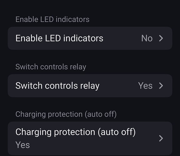

I’ve installed the Aqara wall outlet H2 using the official Aqara app (v1.13.0) for Homey Pro. The Advanced settings indicate I can switch off the led indicator. However, it does not respond after changing the setting and saving it. How can i disable the led indicator?
Perhaps you need to wake the outlet, e.g. by pressing the button on it, while you save the settings in Homey.
Wow! That worked! Thanks so much.
