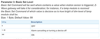

Maybe you haven’t adjust Parameter 3?

by parameter 3 are you talking about Group 3? As you can see in the third parameter the value is set to 255 (which is On).
