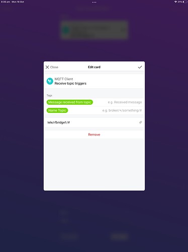

Just change “E3C316” in the logic card to what ever RF code you want to listen out for.
Change “ rfbridge1” to the MQTT topic name that you create for your SonOff Rf bridge ….(if you end up using one)

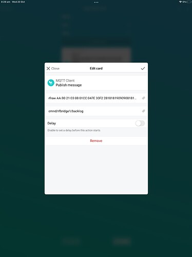

Heres an example of one I use for transmit… Don’t forget the raw 0 command at the end.
rfraw AA B0 21 03 08 01CC 047E 30F2 28181819090908181819081818181818181818181818190818 55; rfraw 0
rfraw 0 Turns off raw mode and puts the RF bridge back into normal mode after each transmission otherwise it just stays in raw mode.
