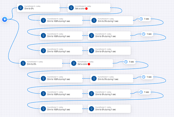

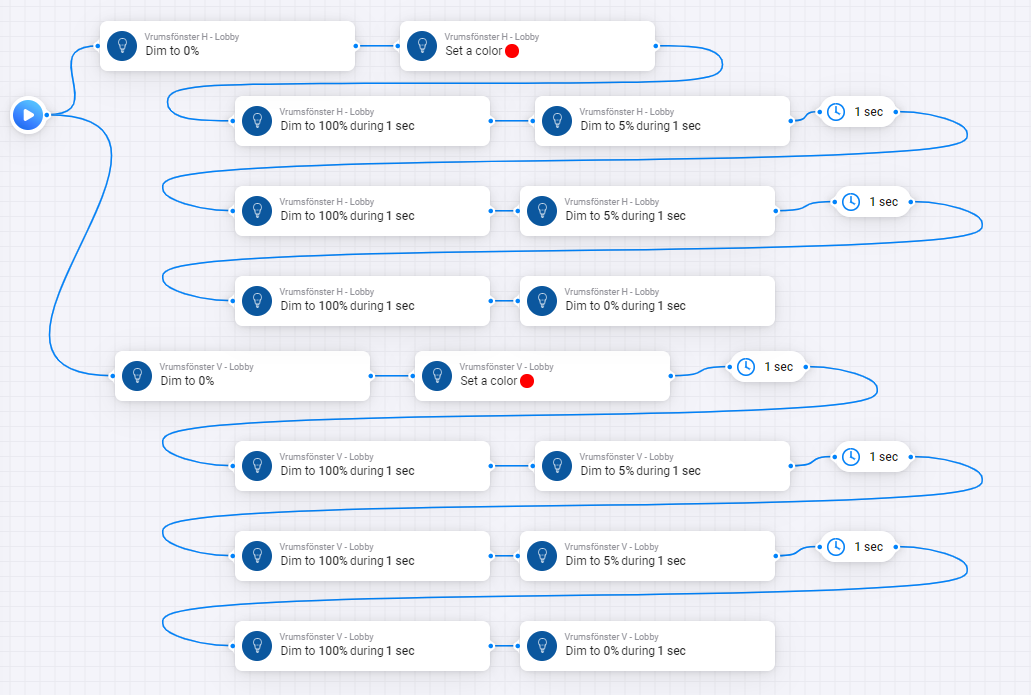

Hi. I wonder about an advanced flow that behaves differently depending if I start it from my.homey.app or if i start it from my android Homey app. Is this a known issue? Homey support directs me directly to the community.
I created an adv flow to:
  1. Turn two IKEA trådfri lamps off
  2. Change colors to red
  3. Set a delay of 1 sec for lamp A.
  4. Dim lamp B 5-100%-5%, duration 1 sec.
  5. Set a 1 sec delay for lamp B
  6. Dim lamp A 5-100%-5%, duration 1 sec.
  7. Repeat 3-6 a couple of times then turn the lamps off.
It works as intended when I start the flow from the PC. But when I start from the Android app:
  1. Neither lamp turns off.
  2. Both lamps starts with 5% dim, and red. The dim level for either lamp does never change from 5%.
  3. After 1 second lamp B turns off.
  4. After another 0.5 sec lamp A turns off.
  5. The end.

As for your question, a screen shot of your advanced flow would be useful in helping you.
First of all, thanks and don’t judge me by this flow. I am only playing around :^)
Starting from web browser works 100% correct.
In the android app I’ve tested to start by clicking the green play button and to start from a standard flow. Same bad result.

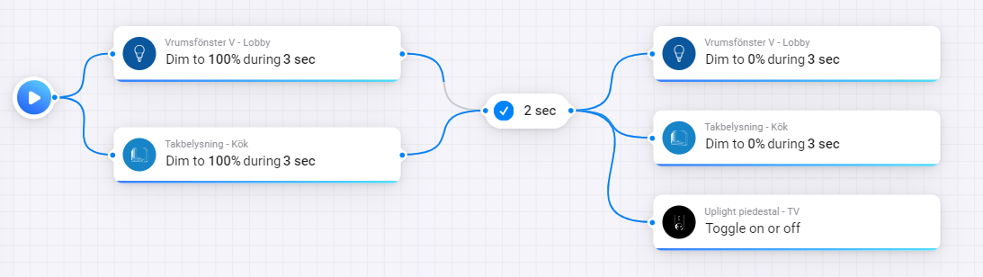

At home and testing. A shorter flow involving Zigbee (IKEA), a Z-wave dimmer (Qubino flush dimmer) and a 433 MHz switch. The dimmables supports “Duration”.
Again, starting in “test mode” is a bit slow but results in an expected behaviour.
Starting in “real-time mode”, either from PC or Android app, the dimming seems to be executed asynchronously. The 2 second delay is started immediately, does not wait for the dimming up to 100% to end. So after 2 secs after starting the flow, the 433 MHz switch is toggled. The dimmables are not able to reach 100% before they start to dim to 0%.
So my theory is that the dimming with a duration is done synchronously in test mode, and asynchronously in real-time mode. Does that make sense?
Edit: Removing IKEA trådfri and setting the delay to 1 sec toggles the switch after one second and the flow is over after 4 seconds. So Qubino and IKEA has the same duration bug, or Homey has a bug.
