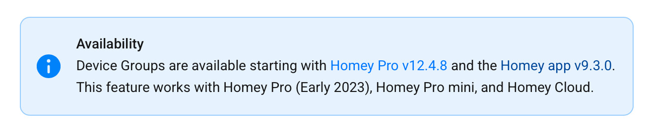

Is this feature really not available on Homey Pro Early 2019?
From the Homey Knowledge Base:
Well…that sucks…
