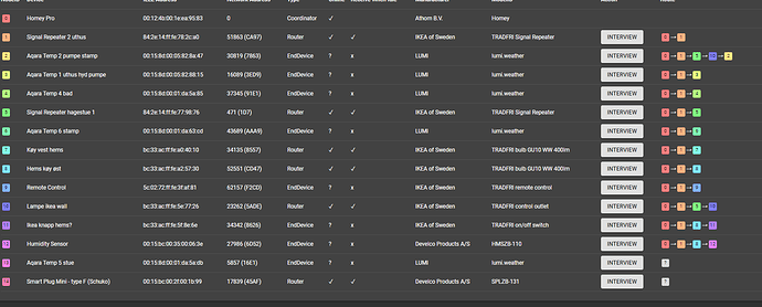

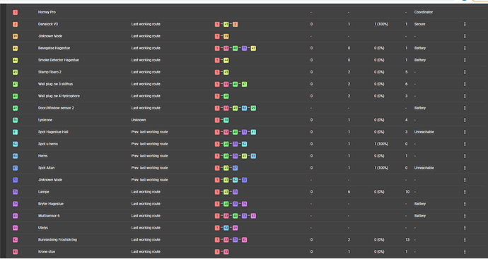

Was trying to check your mesh network, but I guess you’ve pasted the Z-wave network :wink:
Sorry, here is the correct one:
Now without ???
Already two devices gone:
Now only one left, after one hr.
All your devices appear to be linked through the Ikea Signal repeater…
Can you try adding one and keeping one in close proximity of Homey; so that it does not depend on the Ikea Signal repeater?
I am not in the same are as my Homey now, should i try to remove the Ikea Repeater from the network?
I don’t know the positioning of the devices to one another… I do observe that all devices depend on the Zigbee repeater.
It could be that the repeater is needed to bridge the distance between Homey and all other devices (simply due to distance); but that would mean that Homey is positioned at the far end of the house and all other devices are at the other side of the house.
