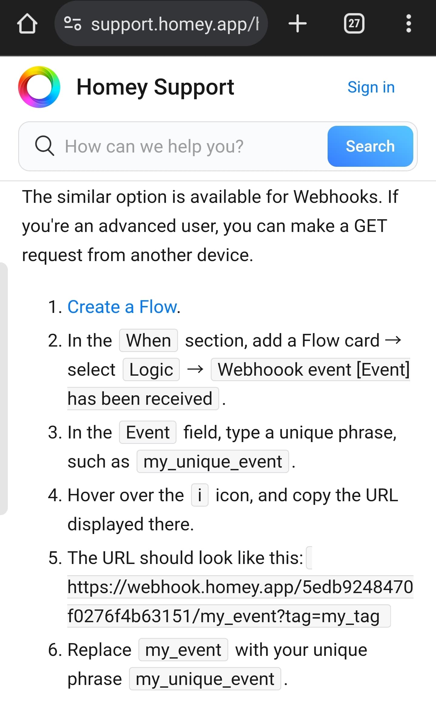

You can use webhooks for this. But I’m not sure if you’re looking for something else.

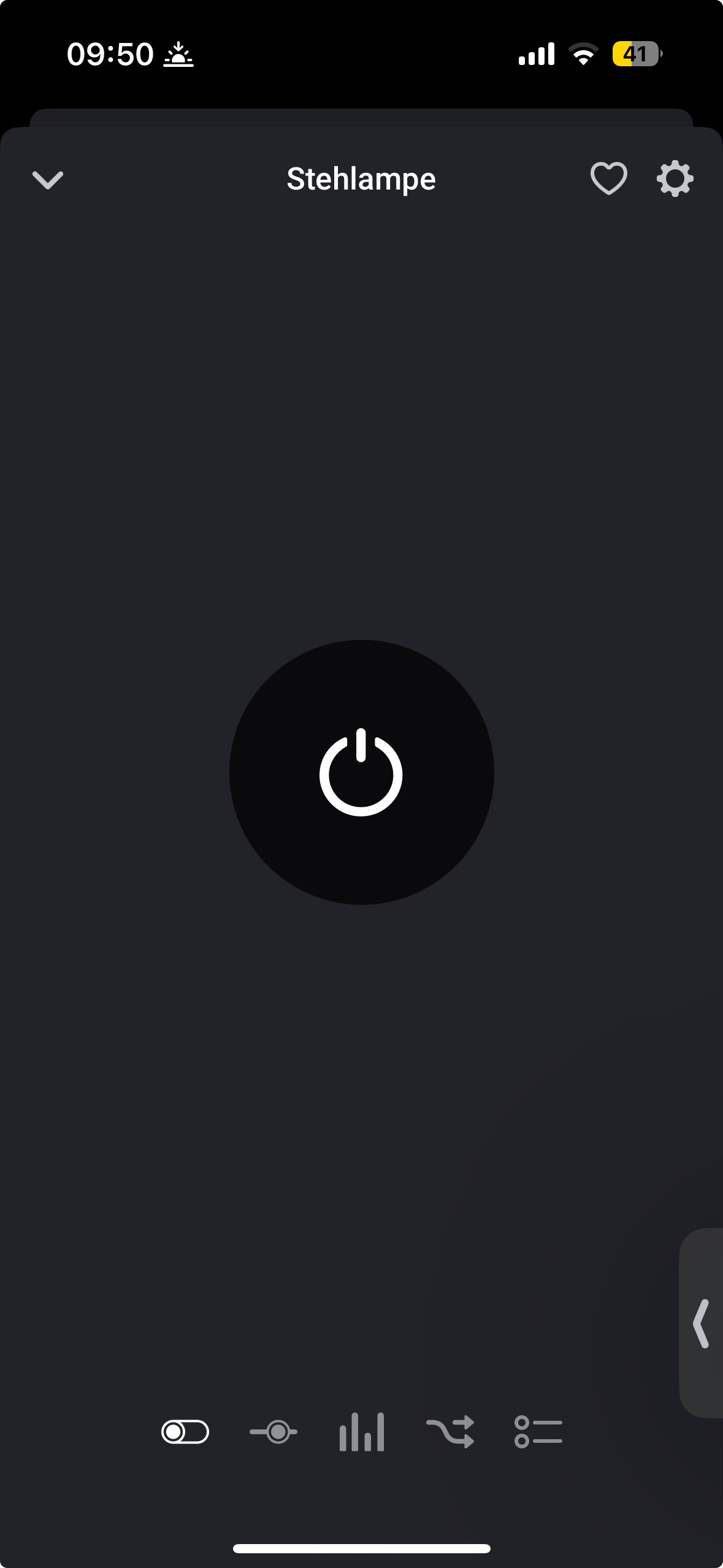

This works if I for example would want to run a flow or change the state of a device. But what I actually want to do is open a specific device in the app via a link:
