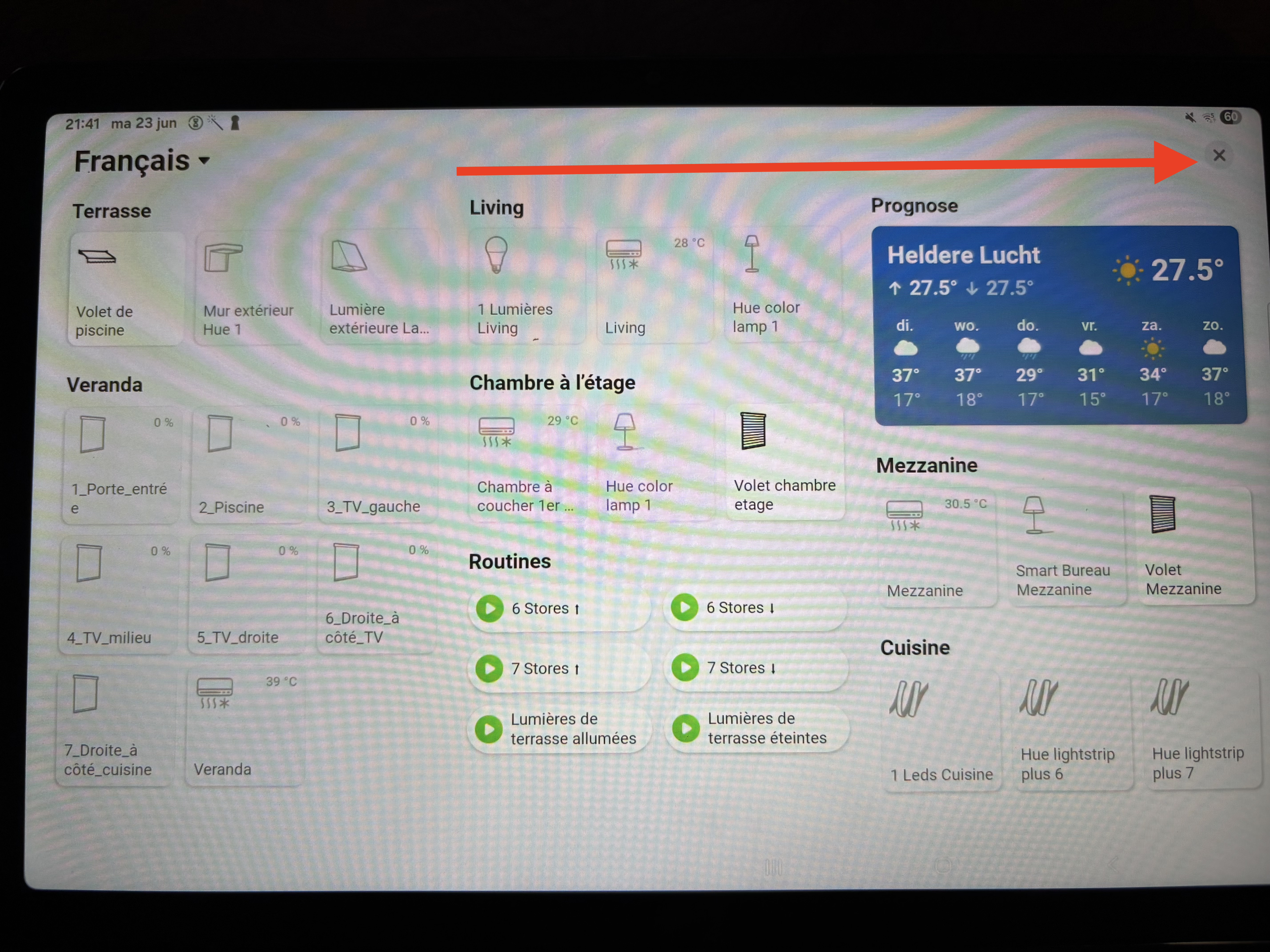

I followed exactly your guidelines, but the user can stil ‘excape’ from the Dashboard… It is a Android tablet… Please see the attached picture.

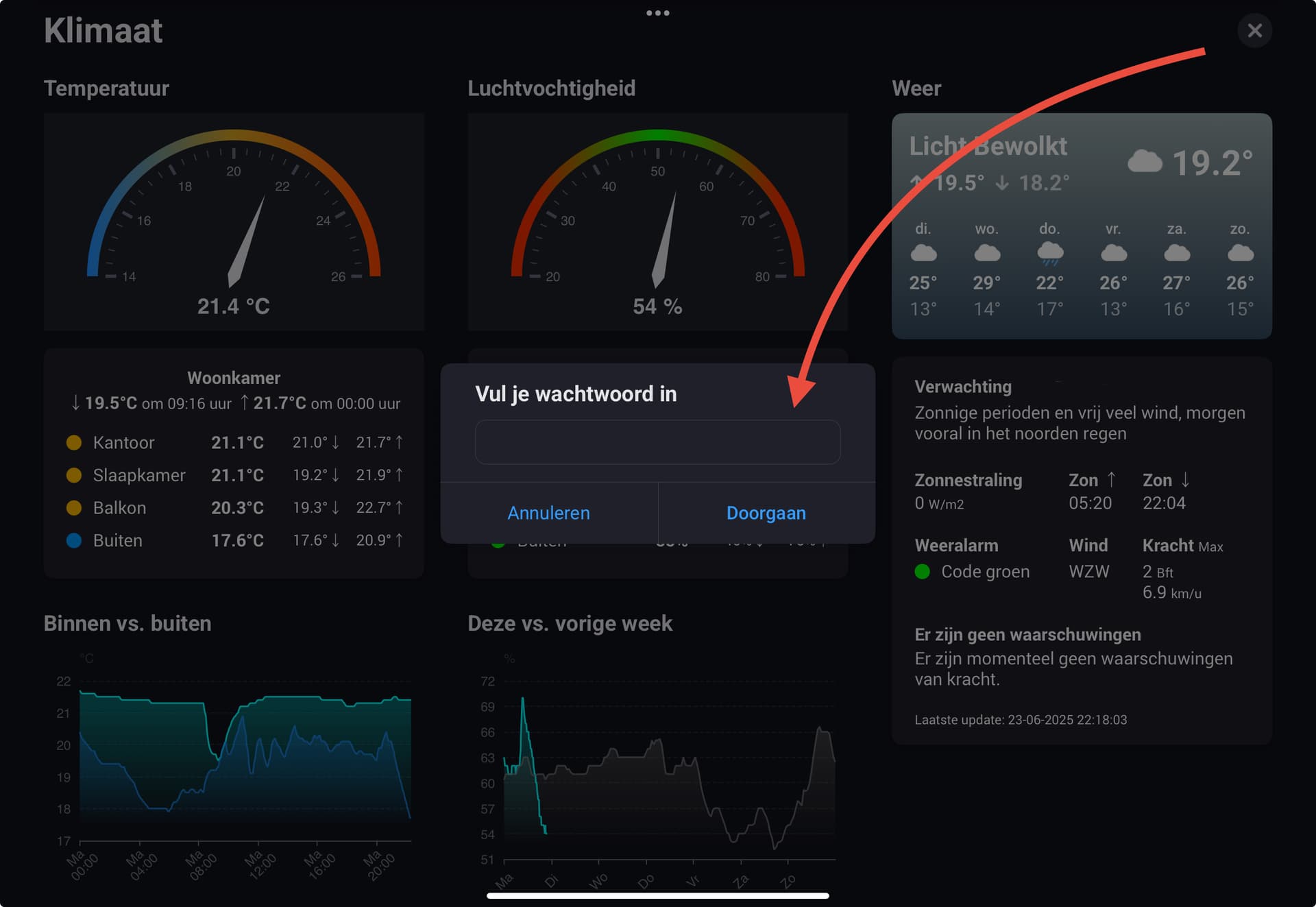

If I (as owner) start kiosk mode, I have to enter my Homey account password. Next if I press the X button to close/exit kiosk mode, the app again asks for the Homey account password. I cannot exit kiosk mode without entering the said password. This is on iOS/iPadOS.
On Android, does the Homey app not require you to enter a password?

It worked… I received an message that the firmware needed an update, I accepted and afterwards, when pushing longtime on the ‘Dashboard’ I indeed received the option to enter the pasword… Many thanks for all your help!!!
