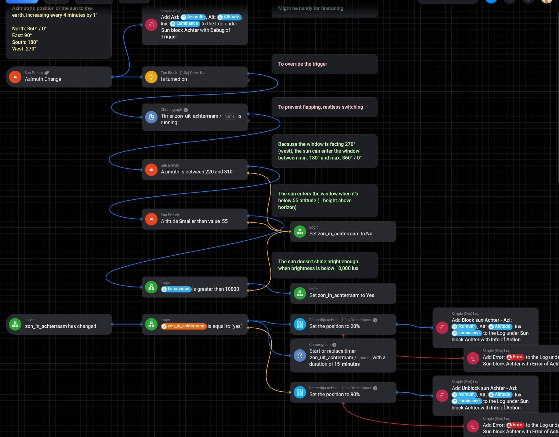

Create flow to control blinds by azimuth
it is possible to know the position of the sun (azimuth and elevation) with the homey pro. then I will create my fulxes to control the blinds
Yes, it’s possible with the app Sun Events.

Do you have an example flow you could show using the sun events app with the azimuth and elevation to control the blinds.
Ita somthing id like to do with my blinds rather than just LUX level

https://community.homey.app/t/sun-tracking-outside-shutters/107863/9
Below, a snippet of the output of the trigger log chart, in which you can view the values of azimuth, altitude and the lux values from my light meter, on certain timestamps:
