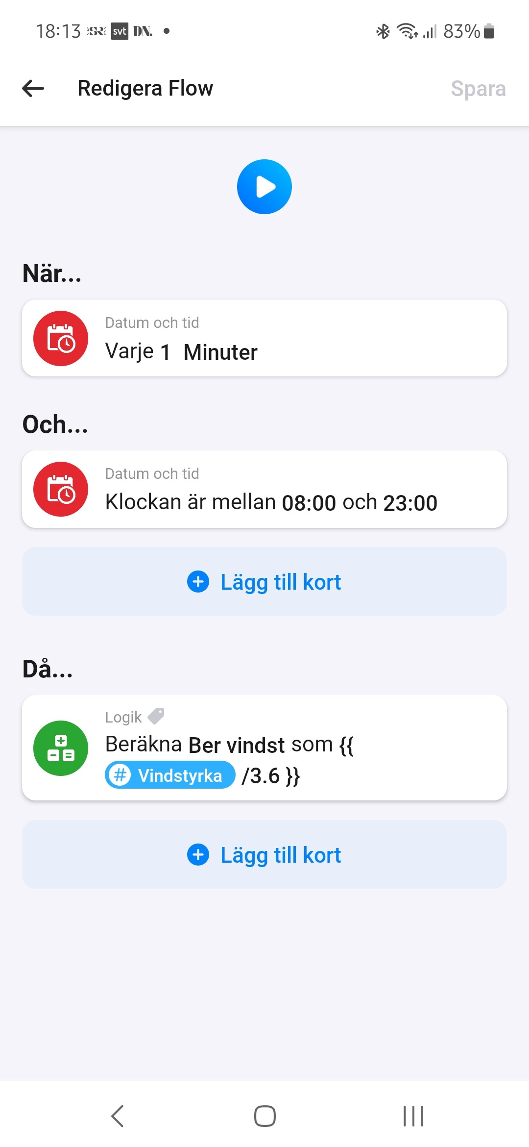

Yes, I made it in a flow. See encl.
Ok, ThanksPeter!
Hi Peter. How do you get the Variable to “connect” to the Value of your Netatmo number? Is it possible to explain more for a dummie like me on what you put inside the variable you have to create?
The variable #VINDSTYRKA comes from Netatmo in km/h and I create a new variable in m/s as a division of #VINDSTYRKA divided by 3,6.which I use to present the wind strength (Swedish = Vindstyrka)

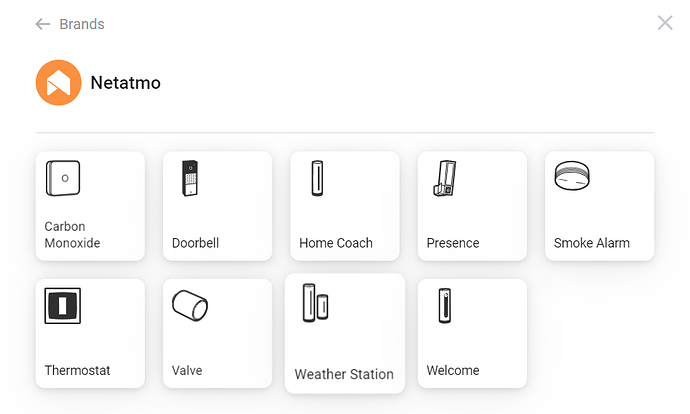

How were you able to connect the Netatmo Windmeter to your Homey device? I can’t seem to find the Windmeter in the list of devices within the Netatmo app for Homey.
Thanks!

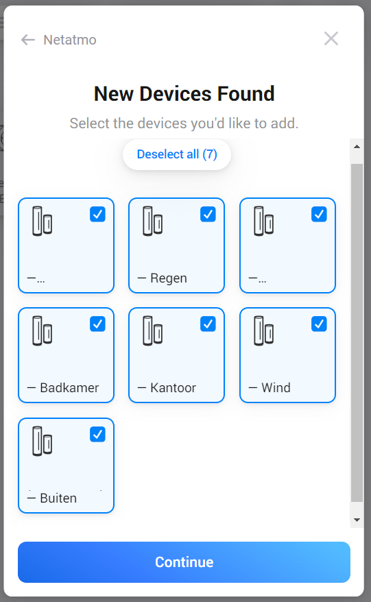

When your NetAtmo Wind Meter is connected to the NetAtmo base Weatherstation, add / update your NetAtmo Weatherstation in Homey:
All Weather Station devices are shown :
Hi Gergory,
Hmm… that’s strange, it appeared when I installed the Netatmo app:
Try to reinstall it after deleting the app from your Homey. I am using Homey Pro 2016…

Does this(picture) flow work the same as sugested above?
I cant get any of the soulutions discribed her work. Im not good at all with this. I just bought my Homie pro a week ago or so.
But it would be great to get the m/s thing working.
Hi @Christopher_homey
You forgot the 2 {{ at the beginning and the 2 }} at the end
And 2 many ( and )
{{round(Vindstyrka*0.2278,2)}}
Rogier
Do i need to make some new variables (#) to make this work?
No, just use your own variables and see what happens when execute the flow.
The screenshot is just an example
This is what happening… But i cant see no change.
Do i need to make a Virtuel device from my netatmo wind gauge and put the flow in that unit?
You are multiply ‘vindsyrka’ with 0.2278. But vindsyrka is a word. This should be a variable which contain a number.
