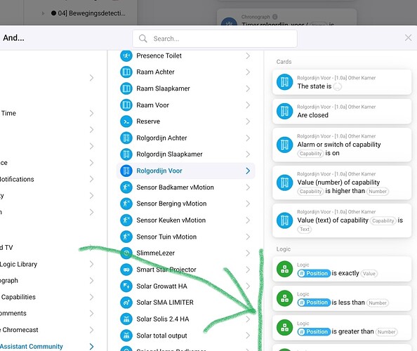

Did you check the logic cards?
All, or many states are avaliable as tags, which you can use as condition:
https://support.homey.app/hc/en-us/articles/4410240765586-Using-Homey-Logic-in-Flows.
The proposed logic cards don’t show all possibilities btw:

Yeah that’s a bit weird @ Homey.
The values we see in the app are calculated, and show us 0 - 100%
But, the actual number (in flows and logic) is 0 - 1 with two digits (25% being 0.25)
