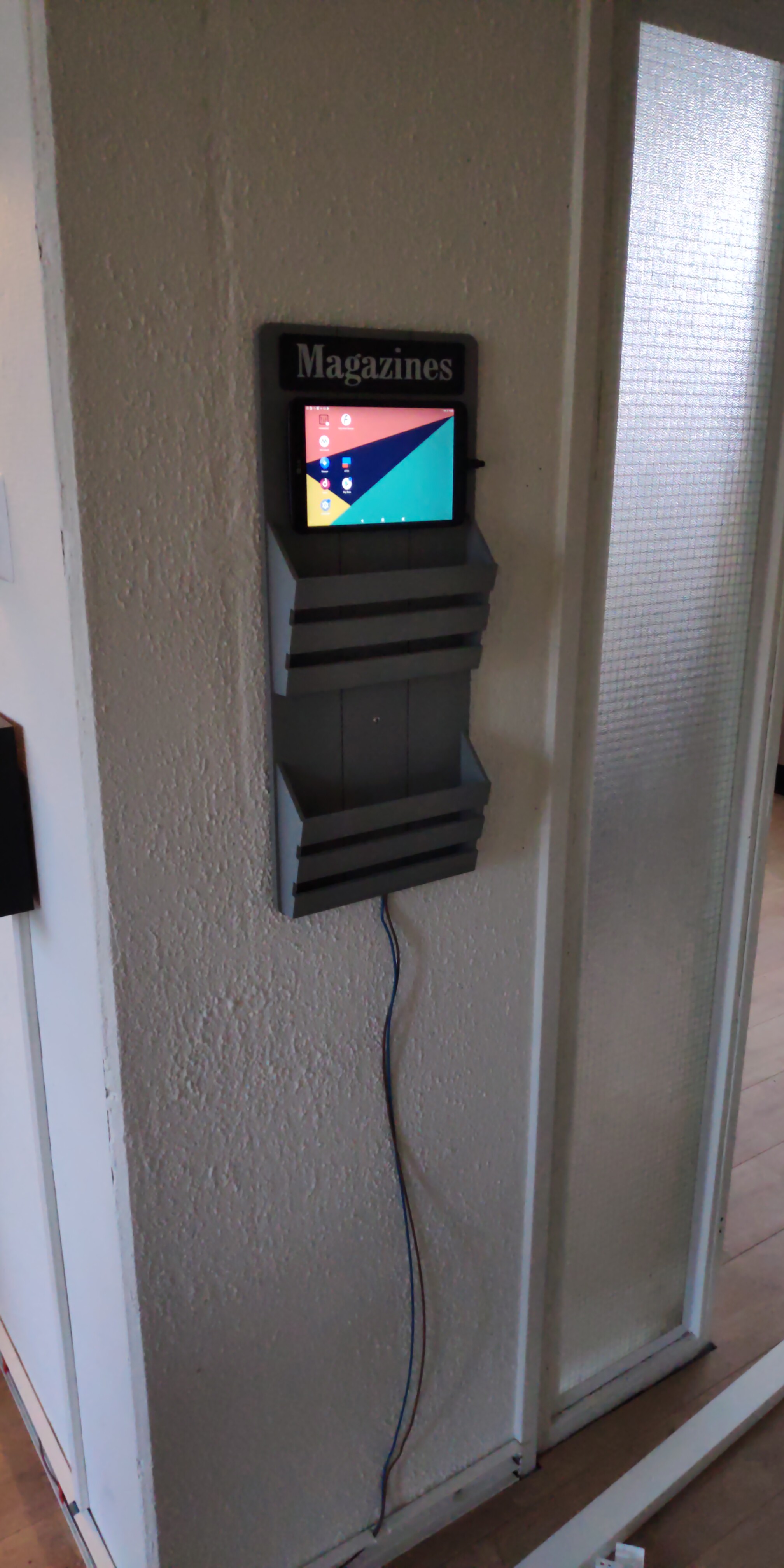

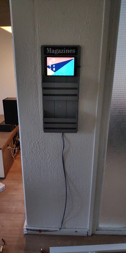

Awesome to see that someone is working on a new dashboard. I installed my tablet today. So, can’t wait!
