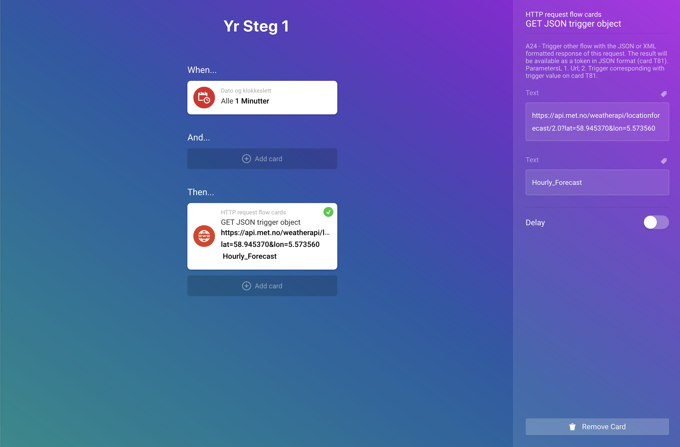

I am trying to follow your receipt in order to get the hourly forecast from this site:
https://api.met.no/weatherapi/locationforecast/2.0?lat=58.945370&lon=5.573560
I would like to store all the parameters (i.e air_temperature, wind_speed, ) for the next 12 hours in variables for use in other flows. However, I am struggling to get it to work (I am not very experienced with programming unfortunately). Do you have any ideas how I can make it work?
How would you store the data in variables for instance? Would you make one air_temperature variable in better logic for each hour, or is it possible to store all 12 hours in an array?
Also, when I try to run I get a flow card error in the second step saying value not found. Can you see what I am doing wrong?

Hi @thudelicious
If you like to have the current hour temperature, the JSONpath expression for that is
$.properties.timeseries[0].data.instant.details.air_temperature
The next hour is
$.properties.timeseries[1].data.instant.details.air_temperature
and so on…
There isn’t any array possibility in better logic or Homey variables, so you have to use separate variables. I think in Homey script there are possibility for arrays if you want to dive into that.
In http://jsonpath.com/ you can evaluate the JSONpath syntax by copying your source to the page etc.

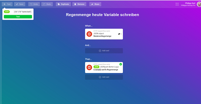

I created 2 flows, the first calls the weatherdata, the second should write the betterlogic variable:
https://homey.app/f/fBxIq7
https://homey.app/f/F9FIq7
I also created a betterlogic variable:
If i try to test the second flow i always get this error:
Thanks a lot
Tip: test your expression with jsonpath.com
With $.forecasts[0].rainTo it should take the rainTo value of the first forecast in the dataset.
i’m getting this error?
thanks
This is not an Error, this is a Test command.
