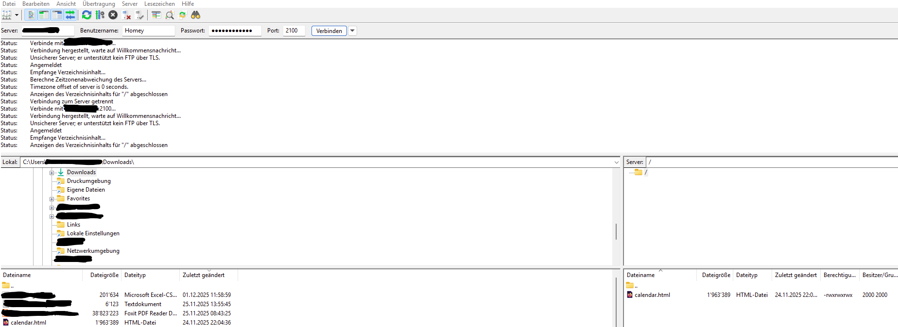

Hello
Thank you for your detailed guide, really great :+1:
But I’m not putting it down :sob:
It works until point 7, then I can’t get anywhere.
When I try:
Is the error message: Cannot GET /calendar.html

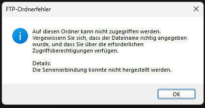

When I try:
If the error message comes: See picture => this translates as the following:
This folder is inaccessible.
Make sure the filename is correct and that you have the necessary access permissions.
Details:
The server connection could not be established.
I don’t know where the mistake is, I’ve tried for several hours now, but without success. What could be the cause, what could I try to find the fault?
Hi! Thanks for trying out my guide! :blush:
The issue: You need to create an FTP user first before you can connect!
Setup Steps:
  1. On your Homey, go to: More → Apps → HTTP/FTP Server → Configure App
  2. Add your first FTP user (username + password)
  3. Note your Homey’s IP address shown there
Important: The FTP server uses port 2100 (not the standard port 21!)
Connect with FileZilla (recommended):
  • Host: YOUR-HOMEY-IP
  • Username: (what you created in step 2)
  • Password: (what you created in step 2)
  • Port: 2100
  • Click “Quickconnect”
Then:
  1. Navigate to the web root folder
  2. Upload your calendar.html file
  3. Access it via http://YOUR-HOMEY-IP:8000/calendar.html
Quick Check:
  • :white_check_mark: FTP user created in app settings?
  • :white_check_mark: Using port 2100 (not 21)?
  • :white_check_mark: Homey and PC on the same network?
That should solve your connection problem! Let me know if it works! :rocket:

I created an FTP user in the HTTP/FTP app:
The upload via Filezilla also seems to work:
I assume that with this step, you mean that I have to enter this in the web browser, right? => Of course with my Homey IP address and port 8000
If I do this, the following error message will be sent:
What am I doing wrong??
I would love to use the calendar on my dashboard :folded_hands:
