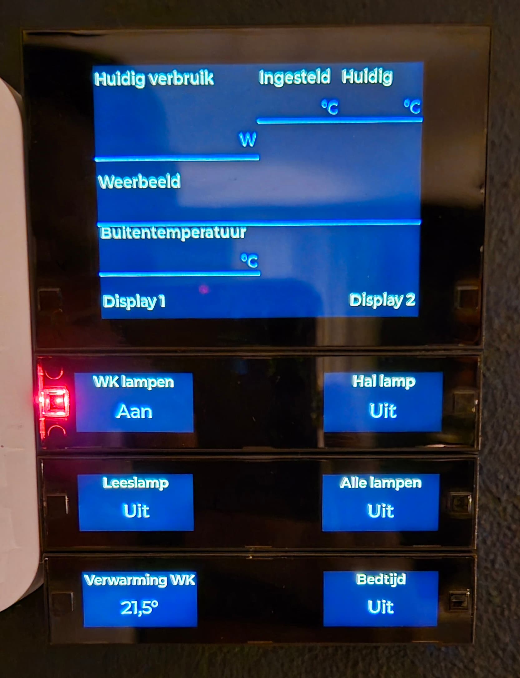

Still struggling with the automatic resending of the configurations after a Homey restart and/or an app restart.
For now it seems that the device is partly updated with the configurations, but the values are not shown… :frowning:
Is this something only I have or can you reproduce?
When I do a “manual” reapply configurations from the device settings this always works flawless…

Hmmm, could something else make the device loose these settings?
Sometimes when I get back to the device it shows the screen like in my post above.
Always thought that was after a restart of the app or Homey…
Ah, I restarted Homey now and after it I get the sceen from my post above.
So, restarting the app is fine, restarting Homey is not.
Sent you a new (second) log
The flow (made with Device Capabilities) for re-applying configurations after the Button+ app has restarted, didn’t change it unfortunately.
Only a manual re-apply or a re-apply by a flow that is manually started (last one could be a problem.of Device Capabilities too of course).
