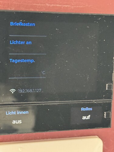

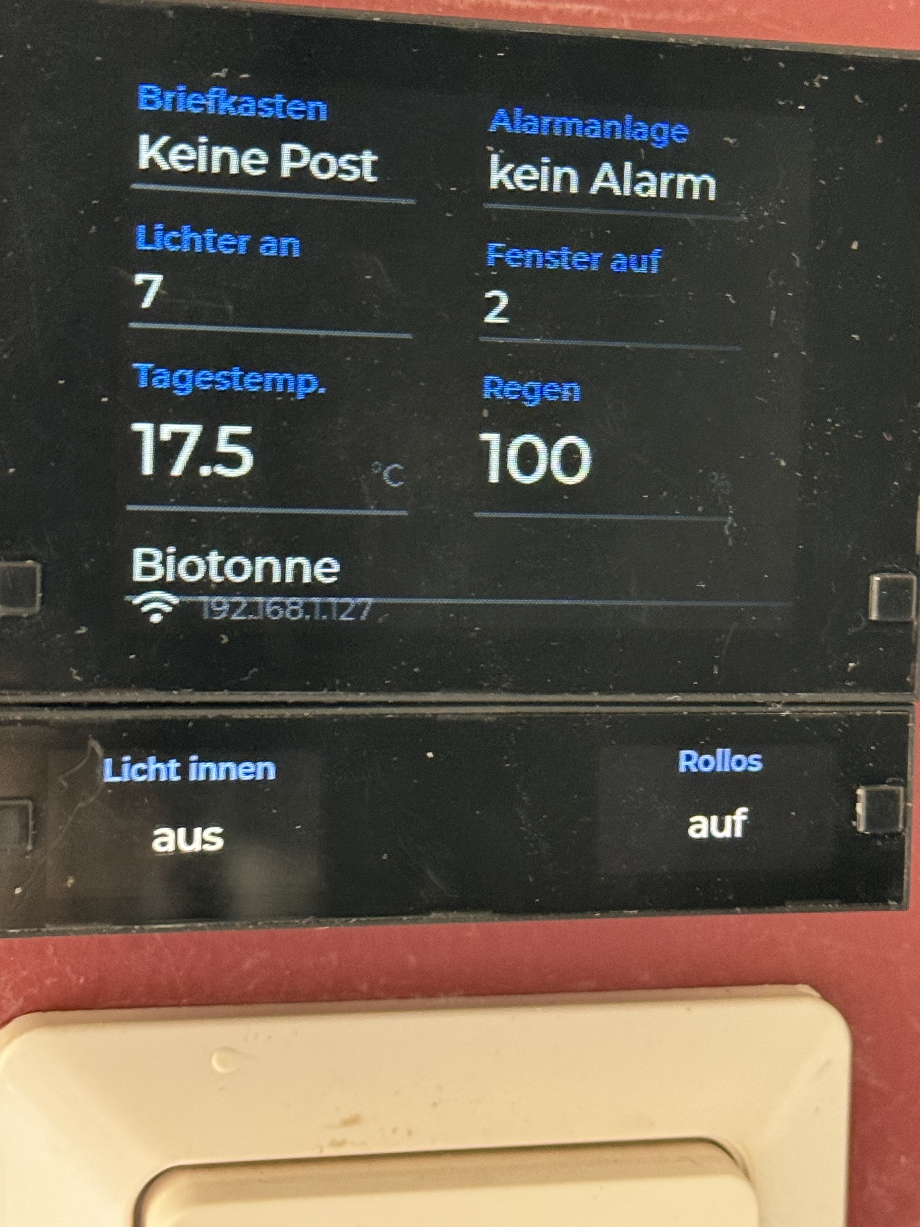

But I recognized, that the Button + often reacts very slow ( display update takes minutes). I wonder, weather there may be a relation to the poor WiFi capabilities of Button+, it seems to stick to the first AP connected and when moved to an other location in the same network, it often looses connection. ( see issues on Github).
So maybee it‘s not the app or the flow, but simply the Wifi? Adrien checked the flow and for him it worked well.

Hmm, the updates on the screen are absolutely instant here. If I change a value on my phone a have to do that ‘blind’ and look to the button+ to see it changing. It is absolutely within a second. But… I have adjusted flows to that.
Example, if a display value reflect logic, it is updating I instantly. But for the buttons, I’ve adjusted the flows to update the button label when releasing the button AND when the value (on the button) changed.
Do you have an example what value is updating slow?
Don´t think its related to a special value or action, the web-interface of the Button+ and my router often show lost connection.
So as some flows are not executed, I think this is not the problem of the App but due to lost connection. Don´t know how to reset the WiFi-Settings to get get better signal from a closer AP, as the Button+ seems to keep one special AP in mind and doesn´t care for Mesh.
Not sure, if this helps for @Rene_N s Problem or mine, but that´s my last idea to follow to make flows run…

Thank you both for your help. My Button+ is placed next to a Ap (AVM Fritz) which has a strong signal, but it doesn‘t connect to it. Modt of the time it shows no values, it refreshes only with a reset (pressing both buttons) I do not understand why, but I will check with the new Update Flowcard
