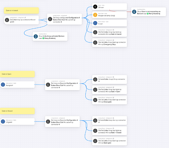

After the update of 3 hours ago I had to deactivate the integration with Button Plus. Since this update (I haven’t changed anything and wasn’t even at home to touch the buttons) it thinks that a button (connector 4 left button with me) is constantly pressed (on or off in Flow). Homey automatically deactivated the associated flows, my gate could not open anymore when I came home (manually opened it as it continued to emergency stop it). I added a push notification when triggered and in a couple of seconds it triggered over 20 push messages or something. Happy to help you debug.

It sounds as a loop in a flow. Is it possible to share the related flow?
So physically when the gate opens (license plate recognition) the gate sensor activates, causing this flow to trigger and it marks the button as inactive, which triggers the “in transit” part, which sends an impuls to the gate (causes the emergency stop when it was opening due to the license plate recognition).
I think I figured it out. It seems that what was previously working stopped working after the update (or another reason changed why it worked and does not anymore).
I’ll change the flow as I cannot change the state of the Button Plus when the sensor is activated and than use the states on the button plus to also control that same gate.
My Dutch is not good, so I am struggling to read the Flow, but my understanding is you want to use the button to open and close the gate plus act as an emergency stop while it is opening and show the states of Open / Closed / Moving?
Edit: Plus the gate can be opened by the licence plate recognition, etc.
In have the log, but it only has the start up messages and no event information for the states used in the Flow.
