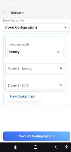

Thank you, Yonas_Patberg, for your quick response. Unfortunately, I’m still encountering the same issue. I’ve attempted to resolve it by restarting and uninstalling the app, as well as resetting Button+ to its factory settings. However, the problem persists. The Buttonplus app functions properly on Homey Pro when accessed digitally, but when physically pressed, there is no response. Any suggestions or further troubleshooting steps would be greatly appreciated. Thank you in advance for your assistance!
Could you check in the app settings that the
Homey MQTT broker is enabled and set as the default.
When I installed the Buttonplus app, there was no option to choose between enabling or disabling it. However, the app indicated that Buttonplus takes control over Homey Pro.
In the Homey app, I have the choice between a standard broker and Homey, and I choose Homey. Currently, I have left 2 brokers in the Button+ web app. When working in the Homey app, I assign the broker from Homey during allocation.
Does this fully address your question?
The Homey app takes control of the button + and overwrites all the settings made in the web app.
In the Homey app settings page, there is a section for brokers and that is where you need ensure Homey is selected as the default.
Thanks Adrian for your prompt response. It appears that I don’t have a choice between brokers, and that Homey is the only option available. That’s already set as default… Is there anywhere else I could make a change? I feel like it should work, but it’s not.
What version of the app are you using?
Can you try opening the advanced settings of the device and select the Apply Configure maintenance option.
