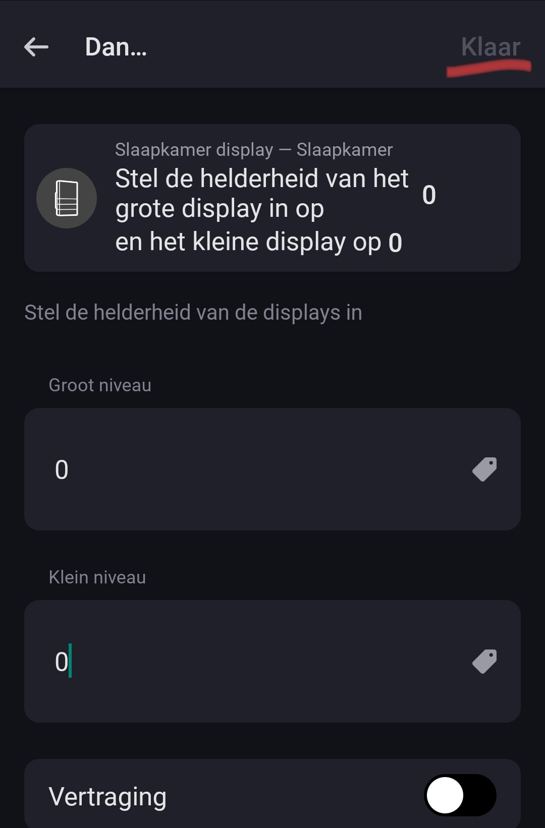

@Adrian_Rockall I noticed that I can’t make a flow to set the brightness to 0. I can’t save the flow.
I can’t replicate that as the Flow saves OK for me.
What error do you see?
What Homey is it?
Edit; Ah, OK so I can’t save it in the mobile app but I can in the Web app. I will report it to Athom.
The Flow card has 1 as the minimum values, so the mobile app is correct.
New test version now allows 0.

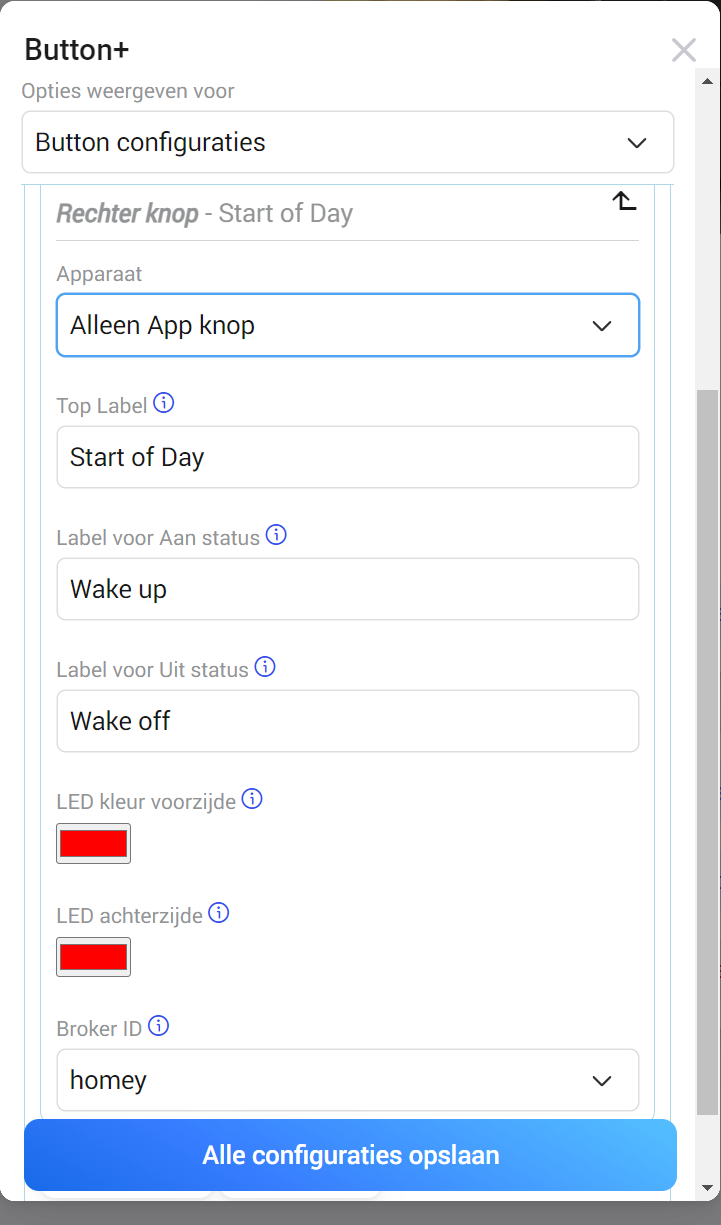

I’m unable to do anything button related (display related it works fine).
So in the button configuration I cannot select a button configuration:
If I select something that has to do with i.e. changing the text of a button it will not do anything (see example) it will respond when I click on the button (push message works), but:
Could it have to do with:
It seems that trying to send a log via the send log function gives an error : Error: Fout bij versturen log: connect ECONNREFUSED
DuMees
Have you selected a configuration for the connector in the Button device in Homey?
