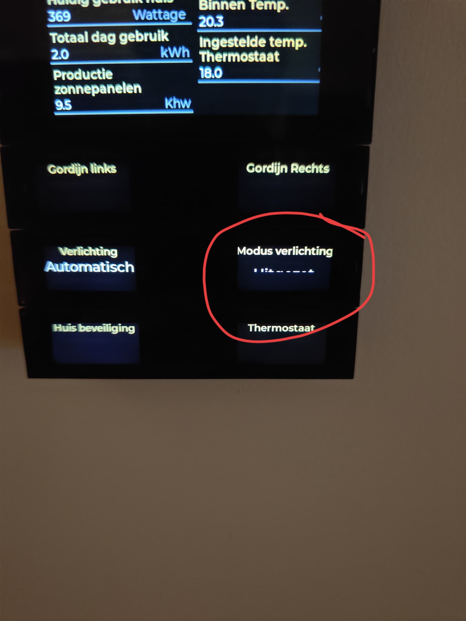

Always when I save button configuration 3, I get this. I must restart the B+ to fix this.
Are you on the latest Button + firmware.
the lastest is 1.08 right? and i’m on Homey App version v0.3.15
It’s 1.081. It has a bigger decode buffer.
