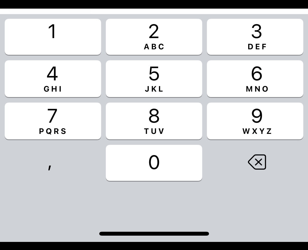

Just curious; I would like to calibrate my Button+ temperature. I’ve got 3 other values in my living room and they are all between 0.4 and 0,6c higher. My idea is to manual correct (advanced settings) my button+ with '+0.5c. But I see that I can only input round numbers.I’ve already found that I can just enter the decimals in another app and copy-paste it in this field. This is working. Maybe an easy change to make input of decimals possible in this field?
Strange, I can type in decimals OK. I have mine adjust by -2.3.
Can you type in a . instead of a , to see if that works? If it does then it is a bug in Homey as it is define as a number entry.
Hmm, whatever I do, I do not get a keyboard that allow me to enter decimals?
I can see a button with .- on it on my Android device (but seems the screen shot features doesn’t work when a keyboard is displayed).
Edit: Is your image from an iPhone? Just wondering if it’s an iPhone problem or a language problem.
Yes, it is a screenshot on an iPhone.
I see now what in al other apps I have the ‘,’ available. But in the homey app nowhere (it was there in the past). So I think an ‘issue’ in the complete app. Sorry for asking. I thought that it was an app related setting.
Other apps:
Looks like that is a problem with iOS version of the Homey app. Same happens in other apps and advanced settings that should allow decimal input. I assume the the input field is for a number since the keyboard is automatic to number keypad.

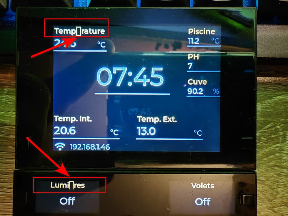

I identify an encoding char issue.
I’m using French language, and “accents” are not showed correctly on physical Button :
The chars are ok under web interface :
Could you implement a fix for that please ?
Thanks.
Button+ support page lists three issues related to these missing characters.
#71 m³ as units
#106 Unsupported character in Label
#121 Scandinavian/umlaut characters do not display
The font in the firmware on Button+ is missing quite a number of characters. So we would need to wait Button+ for a fix.
