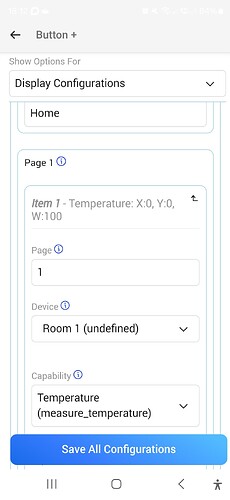

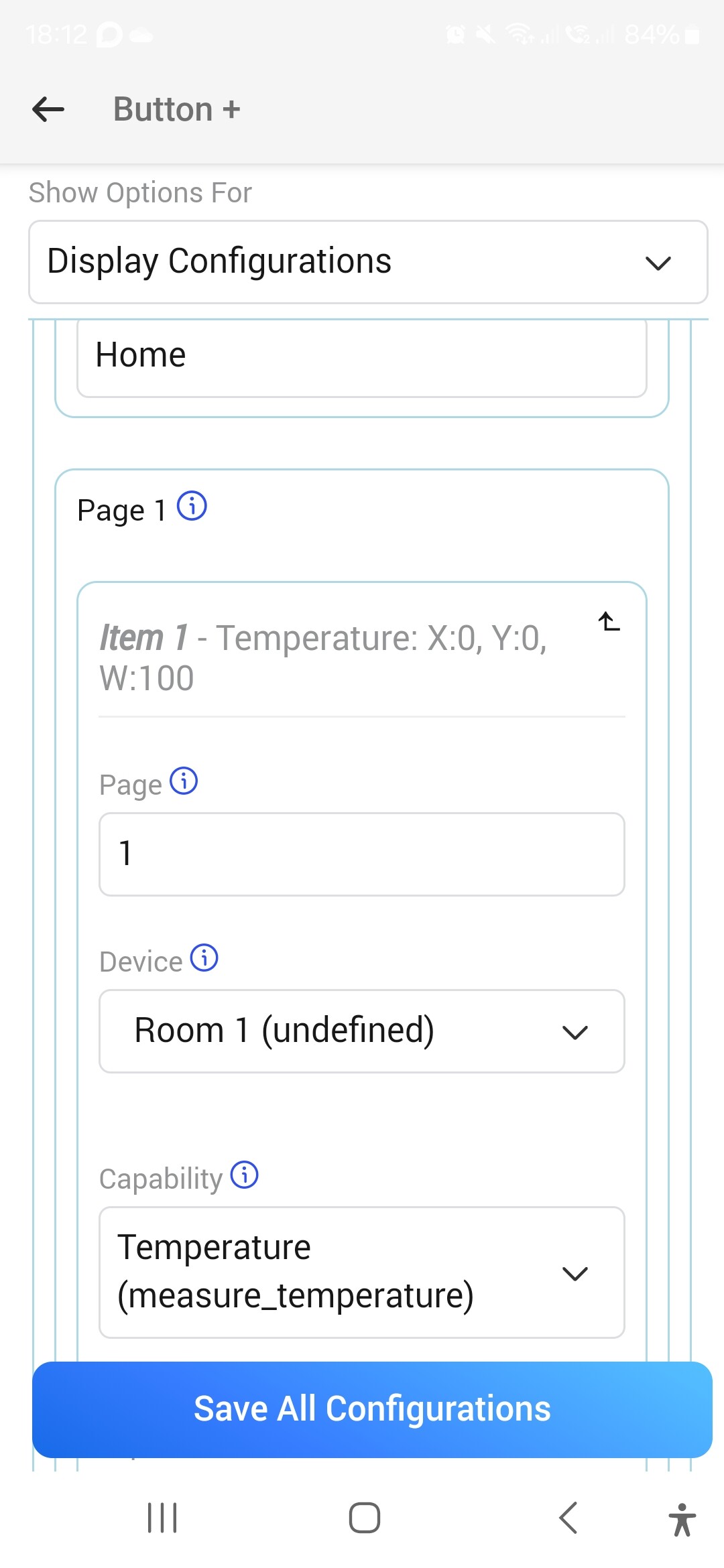

@Adrian_Rockall Having a bit trouble with “re-applying configurations” (either by flow of by the button in the device setting),
It seems to toggle between applying them correctly and incorrectly.
The first time it applies them correctly and the second time it doesn’t. or the other way round.
Hope I am describing it clearly. Sent you a video by PM to clearify if needed. :slight_smile:
I will try to investigate this evening.
New test version should hopefully fix the Apply Configuration issue.
Yes, confirming that is working great again!
Thx for the quick fix @Adrian_Rockall!
