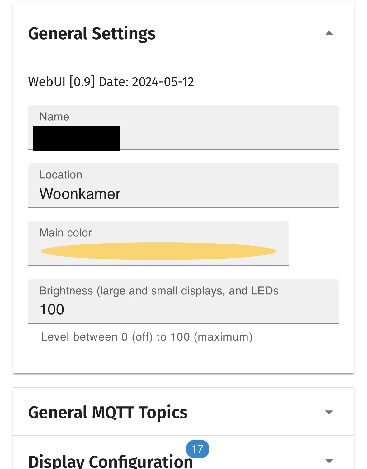

How reliable is the temp sensor of the button plus? I am under the impression that it’s quite off. If I compare it to another sensor I have a 3 degree difference
Found the calibration option in the app settings. In the mobile version of the app no negative offset can be entered. In the web version I could!
Glad you found the solution. I will report the issue to Athom.
