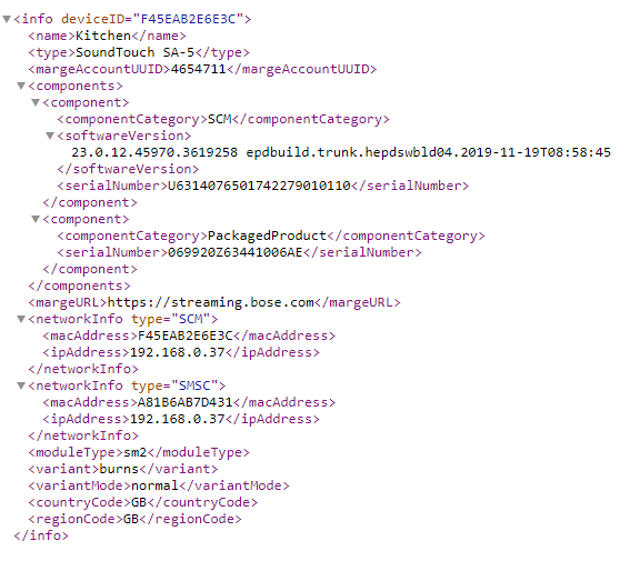

Hi SlicingHaunt, will the SA5’s be discoverable as well in the next version? I’m new to the app so am tagging on @Nigel_Scott’s comment that it used to work with SA5 until recently.
Please see the output from the SA5 IP address as above:
KitchenSoundTouch SA-54654711SCM23.0.12.45970.3619258 epdbuild.trunk.hepdswbld04.2019-11-19T08:58:45U6314076501742279010110PackagedProduct069920Z63441006AEhttps://streaming.bose.comF45EAB2E6E3C192.168.0.37A81B6AB7D431192.168.0.37sm2burnsnormalGBGB
Let me know if you need anything else!
The XML seems to be broken by the forum. Is the value that is between the <Type> tags SA-5 or is it SoundTouch SA-5 ?
This seems to be how it shows when I go to the address, in both Safari and Chrome
I have the discovery tool but that doesn’t show much either. Do I need to access it differently?
