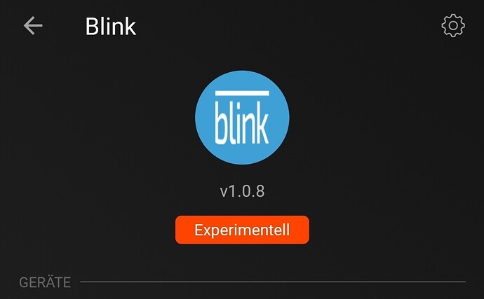

Hi, I tested adding a outdoor camera with the test version 1.0.8. It’s working well.
Please check, if the test version is installed (with the blue icon)
