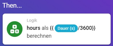

Joka
October 27, 2019, 7:48pm
#13
in the app settings of Logic you have to define a variable (hours) before
Flow:
when: stop watch stopped
then: based on the duration, Logic calculates seconds to hours
Joka
October 27, 2019, 9:38pm
#15
You post the options of the when area. But you have to select the options in the then area.
