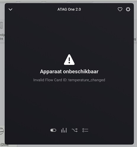

I now installed the offical release and have the following issue:
I’ve made an update to the app and are awaiting review
09-01-2026 Update:
The new version is live
Solved, Thanks
