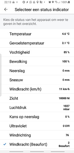

Hi Ronny, thanks for all the work and your views.
The 1h ahead device installed well.
Now, this device has 13 enum capabilities, and n# 13 (Windforce Beaufort), is slightly visible in the device ‘Status Indicator’ selection view.
After quite a few hit and miss, I was able to select it :crazy_face: (setting a smaller phone font did not help, the table row height seems fixed):
I’m sure it’s an Homey app design (no scroll enabled) for that screen. I will inform at Athom about this.
Cheers

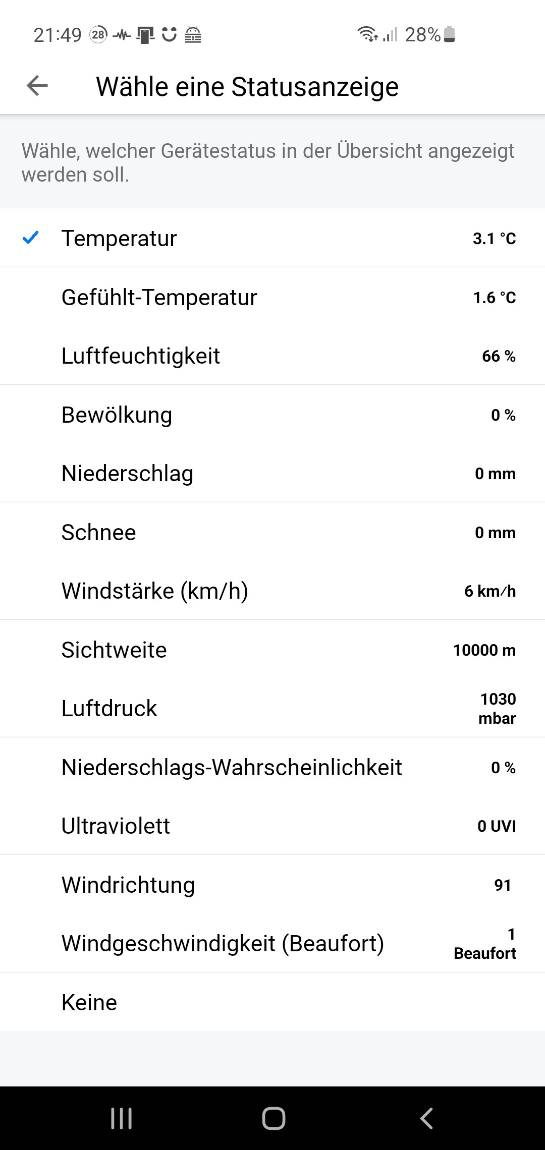

Hi Peter,
yes, that’s a Homey App issue. It seems for me a list with fixed row hight, too.
On my phone with a hgher resolution and some longer german words it seems to be ok.
There shoule be the “none” entry be visibe, too. But I have a fixed bar of android buttons. Have you them configured to hover?

But I have textsize on position 2 from 8 possible settings. Really small. Perhaps that’s a reason why the date/time is not shown correctly in your example.

Thanks, of course the resolution is a factor, didn’t realize.
The bottom bar can be hidden as I just discovered, and now the 13th capability is shown, still “None” is out of range.
This is all of my screen now:
Now I’m waiting on Athom’s reply

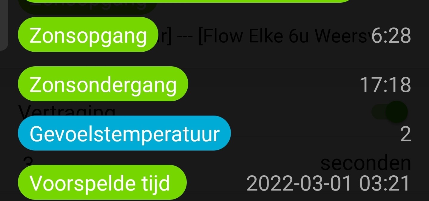

  • Current weather per 5min.
    The time of “Forecasted time” is correct, but sunrise/sunset seems to be at UTC instead of local time.
    At my location the timezone is +1GMT and both timestamps are an hour early.

The problem with the time I will check later. Perhaps the new API is providing UTC timestamps instead of local timestamps. I just copied the logik from the old devices but it doesn’t seem to fit.
That’s wrong for the old devices, too. I think it depends on the Homeys firmware update last year where Homey internally started to use only UTC. I have to correct it for all devices of OWM app.
Update:
The sunrise/sunset should be in local timezone now.
