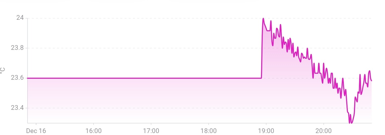

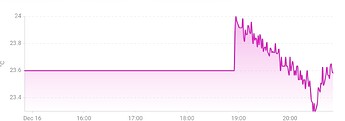

Yesterday i updated my homey to latest firmware(12.10.0) and noticed that the tuya device(i have only one:-)) was unavailable and needed a repair.
Today i received the latest (test) tuya app version (1.0.2) and again the device was unavailable and needs a repair again.
After the. 1.2 update need to repair my devices again @drenso
This is a record. Two hours and it’s still working.
Yeee
You made my day. I hadn’t thought about that angle.
Many thanks!
