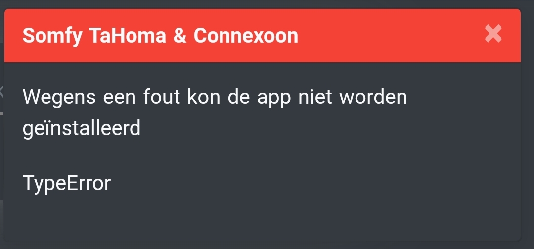

This is the error I saw when I installed 1.6.24:
It says:
Cause of an error the app couldn’t be installed. TypeError
But in my case it did install on a Homey Pro with 4.2.0:

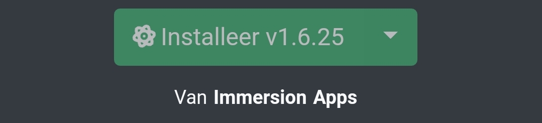

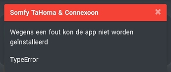

This is what I see:
1.
2. (takes some seconds)
3. Then picture 1 appears together with this:
But again when I go to homey app, 1.6.25 is installed :smile:
